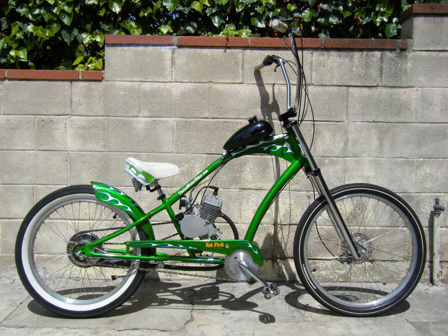

once you have the hole cut out to fit the sprocket over the the hub how do you get the chain to clear the fat tire? i tried spacing it out but then can get the brake arm on any suggestions?
Use a extra rubber rag joint & bend the brake arm.
You also have to make off set motor mounts for the chain to clear the tire.
