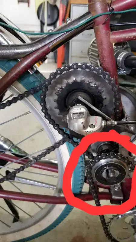

I like what you did putting a sprocket and a freewheel on the jackshaft eliminating the need for a shift kit. I however will be lacing the 5 speed IGH into the rear wheel.
