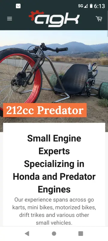

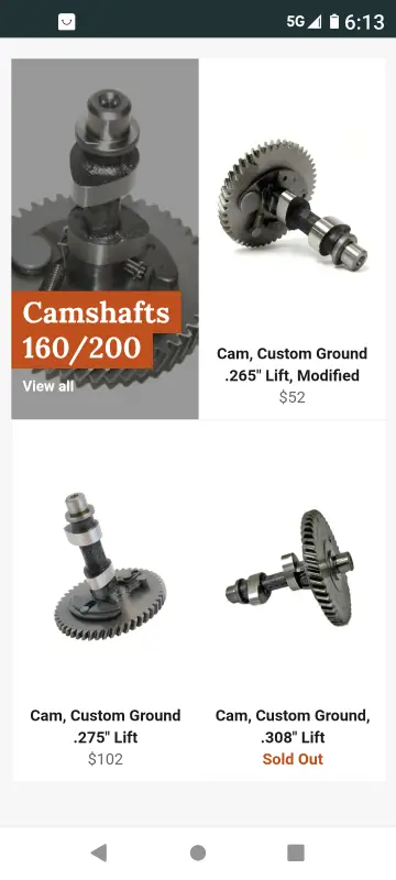

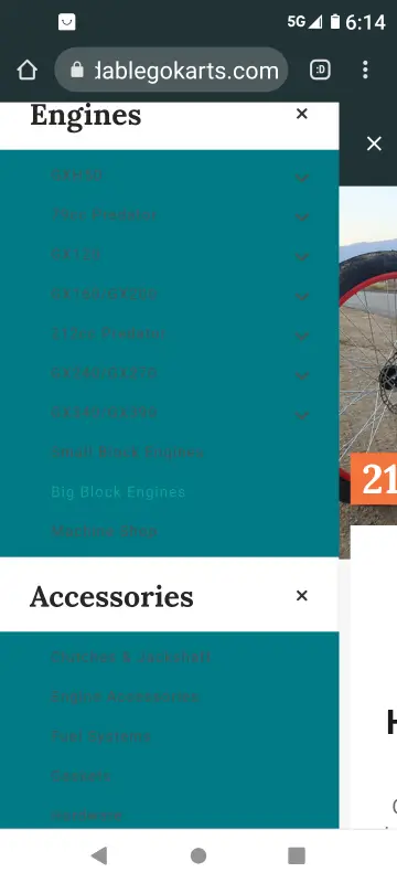

"I measured everything, both valves are the same length, the stock springs are 30mm uncompressed and the 18LB springs are 23mm uncompressed. I just saw on amazon they have 22LB springs that are 35ish mm. Would you advise installing these on a pretty much stock (governer deleted) engine or do I need a beefier cam"
If the stock valve springs were 30mm. the 18lb springs should also measure 30mm. A 7mm shortage of the 18lb springs is wrong. You need to reach out AGK Affordable Go Karts
