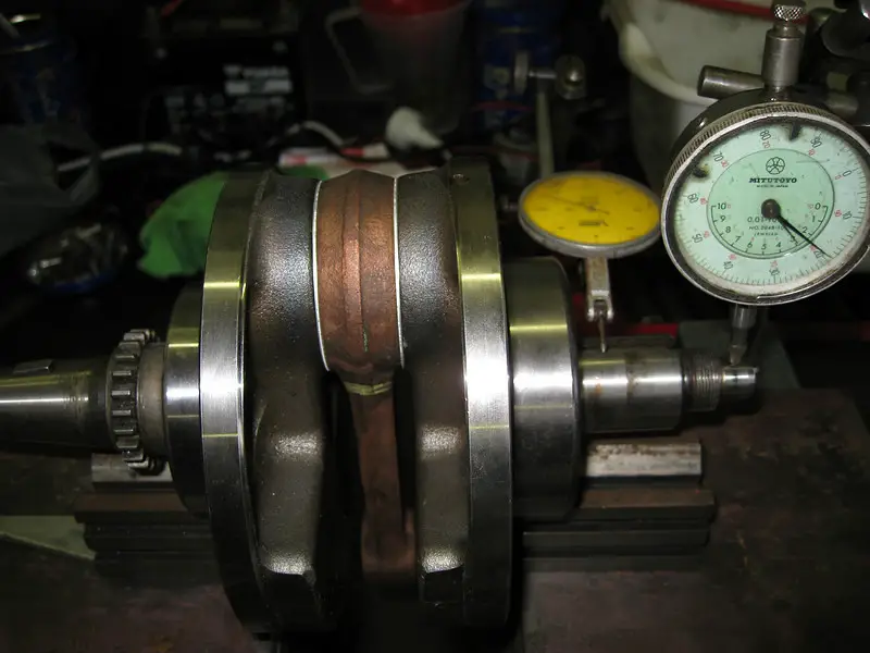

Here it is checking a crank. Support the bearings on blocks (I used magnets to hold them steady) and spin the crank. The dial will tell the truth. My well used 66cc engine was within 0.007" at the worst spot (crank cheeks, side to side). Freehand beating it with a brass hammer got it within 0.005" and less than 0.001" on the journals. It was less than 0.002" there before I started.
Here is someone doing a HT crank in a lathe rather than on blocks. Either works, but I have a couple 2"x2"x4" steel blocks and 4 magnets.
