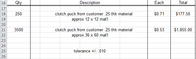

The first number to lay into the equation is material. As I said earlier it is about $60 per sq foot and I have to buy it in 3'x5' sheets so a full sheet is $900 (ouch!).
The next number is the cost of getting them done on the water jet. I thought the material price was high till I got these numbers.
This translates to:
Material:
$60 per sq ft divided by 250 pucks per foot = .24 ea
$900 for a full 15 sq ft sheet divided by 3500 pucks = .26 ea
Price per set materials and labor per sq ft production run:
.71 Labor + .24 material = .95 total per puck X 15 pucks per set = $14.25 per set
Price per set materials and labor for full sheet production run:
.53 Labor + .26 matterial = .79 total per puck X 15 pucks per set = $11.85 per set.
Yield:
250 pucks per ft production run divided by 15 pucks per set is 16.6 sets per foot
3500 pucks for a full sheet production run divided by 15 pucks per set is 233.3 sets for a full sheet
As you can see the advantage is a full sheet run but it would be a very slow return on the investment of that size. And as I said this is not factoring in my time to cut out the pucks from the sheet, deburr, package and ship them (not counting gas for transportation and other real related costs like electricity and shop supplies).
Any comments? I will be taking the material I have on hand to get what I can cut out in the next week or so and make a few sets available at cost for testing but it sure looks like if I sell this to the retailers and make any money at all on my end they will probably have to be in the $20-25 range unless I can swing doing a full sheet production run.
