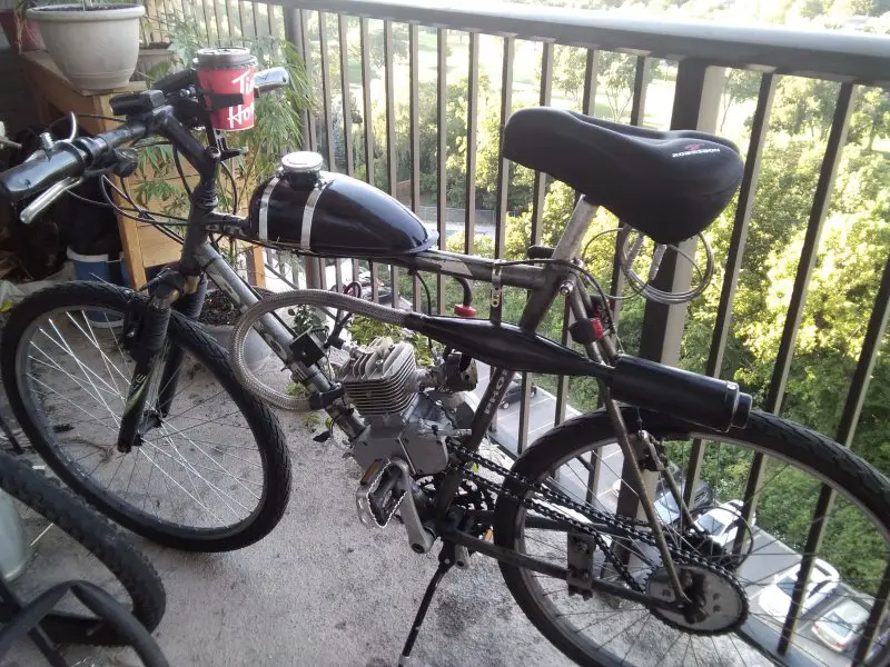

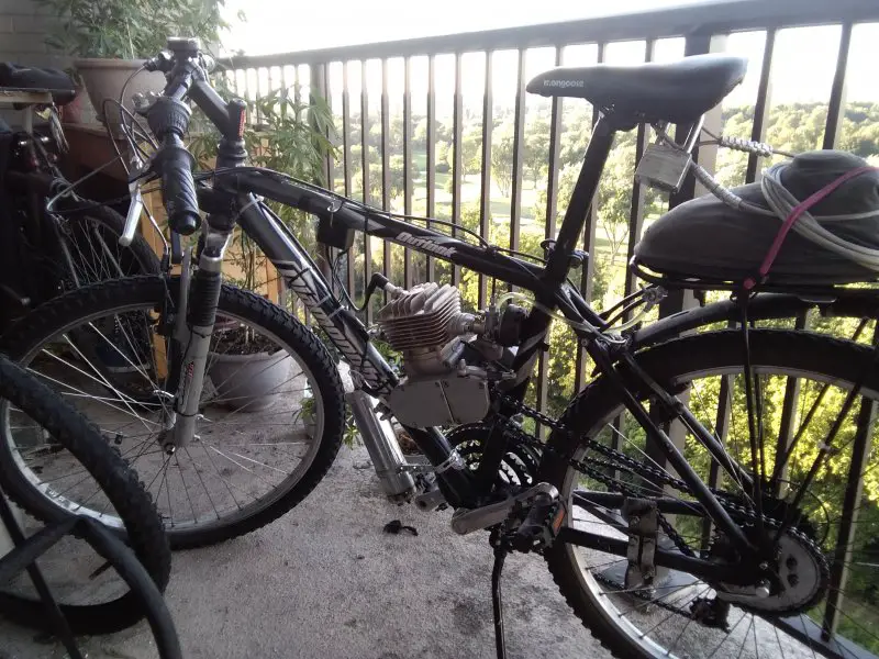

Bought myself a BT100 from Zoom in BC, got a good price and shipping during covid was easier internally in Canada.
Got it to stay off public transit and stay employed a technicality with what I do.
So this beast, torque monster hauls very well with a 25:1 mix and the jetting done, 36 tooth on the back, cored out the muffler completely, and that's it except normal maintenance (clutch adjusting, nut and bolt check, filter clean).
Turned 1000km today still strong
