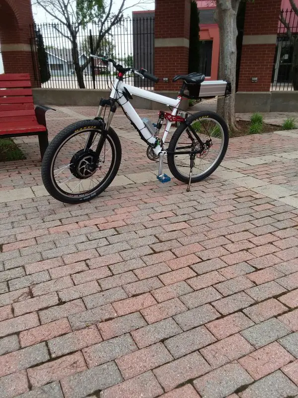

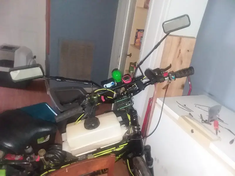

Martin welcome to the forum! My less than ingenious solution to the problem on my MB was the run the half grip throttle on the left side. It's not hard to adjust to this even though it reverses the twist motion to forward rather than backward twist. Also the control buttons and screen or lights are reversed as well. After a few rides one adjusts to it. It's really quite intuitive & I've now two bikes set up this way; one is a hybrid gas/electric with twin throttles that I operate simultaneously....no problem. Though it sounds Micky Mouse in explanation it looks and works quite well.
I did try to find an electric half twist throttle but was unsuccessful, though didn't expend a lot of effort searching.

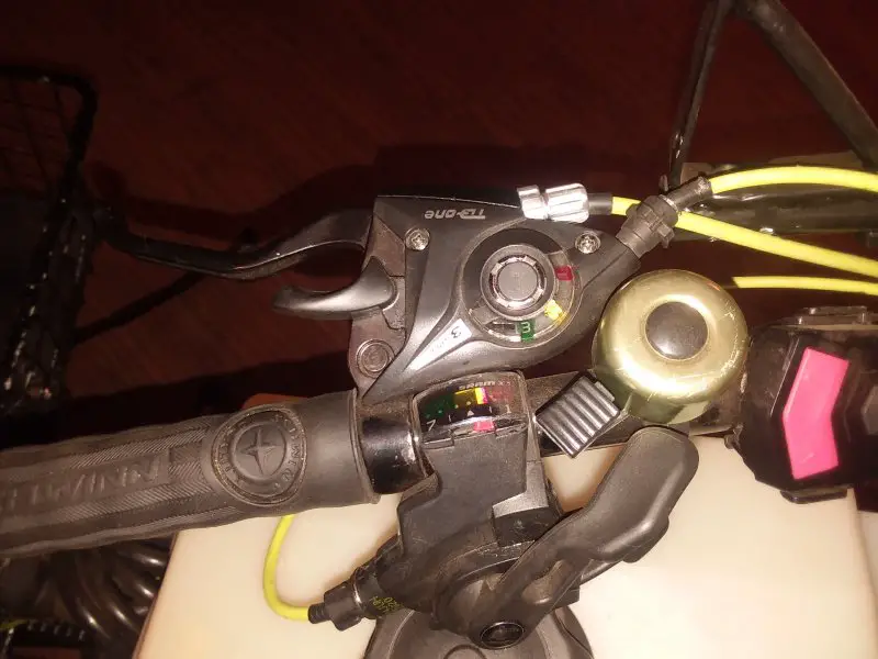

I use a triple chainring shift kit.
Here's my solution to the problem. I got a regular brake lever for the right handlebar and also put the twist throttle on the right side.
On the left handlebar I put the Shimano 3 speed/brake trigger shifter and a Sram 7 speed trigger shifter. This way all shifting is done with the left hand. There's also a color coding system. The bike gets shifted like this:
Red
Steep hill climbing and heavy load pulling
1(1-3)
Yellow
Around town general use
2(3-4)
Green
Down hill and open road use
3(5-7)
The only time a front chainring is shifted is when either in rear sprockets (3) or (5).

Sidewinder Jerry
Dec 19, 2011
2,098
1,095
62
Rockwood, TN
Here's how a 3x7 drive system gets shifted on your bike lowest to highest gear ratio.
1(1-4), 2(2-5), 3(4-7) for 12 sequential non redundant gear ratios.
If a gear is too easy or to hard to comfortably maintain a cadence (crank rpm) of 70-90; it means you're in the wrong gear. You can get bicycle computers with cadence meters on them.

Sidewinder Jerry
Dec 19, 2011
2,098
1,095
62
Rockwood, TN
10 minute edit got me again. Wish this forum would fix that to edit any time. Ment to print this.
Red
1(1-3)
Yellow
2(3-5)
Green
3(5-7)
