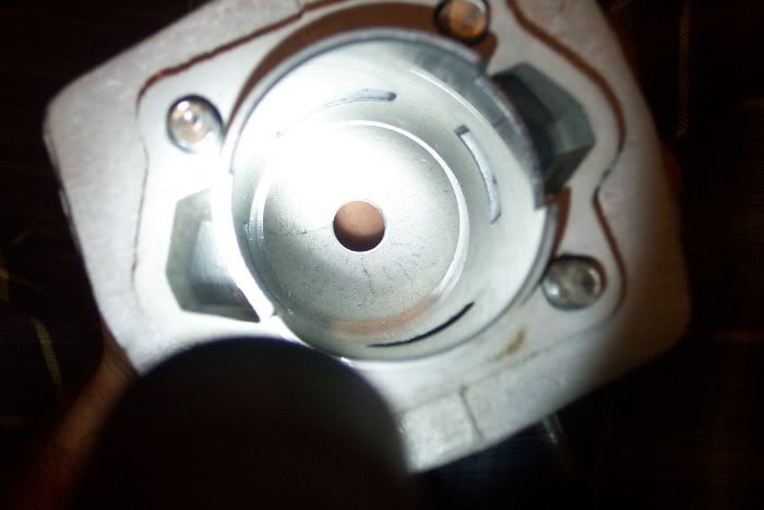

I am working on mine and my buddy who has 55 years working on motorcycles says this is a common performance mod to make the engine breathe better. I'll take some photos and see if it works at all.
just for reference here's a pic of where our squish is.
yeah i know, your thinking to yourself.
"where is it?"
also if anyone is planning on machining a head make sure that you allow for a much better cooling system than what they have now. at least double the size of the fins they come with now, if not bigger.
