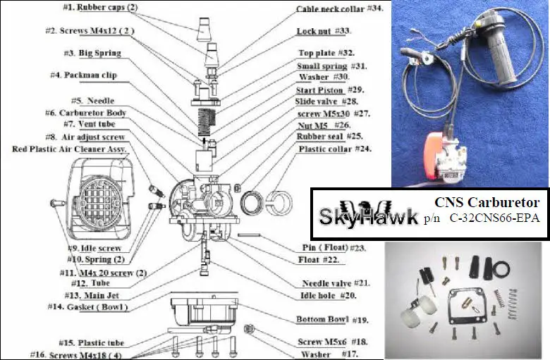

Also, the carb plunger fell apart when changing the throttle cable. I think I got it back together right, pin in first then the retainer clip? Or is that the other way around. I can post pics if needed.
Mat the cns came with the first 6 kits I bought starting in late 2010, all but a couple have had to be replaced. The plastic spacer fell apart on most also. For $10 each I went with the standard nt. It sounds like you have debris between the needle and seat or it may be varnish from old fuel, either way you need to disassemble the carb and clean it.
Maybe this will help.
