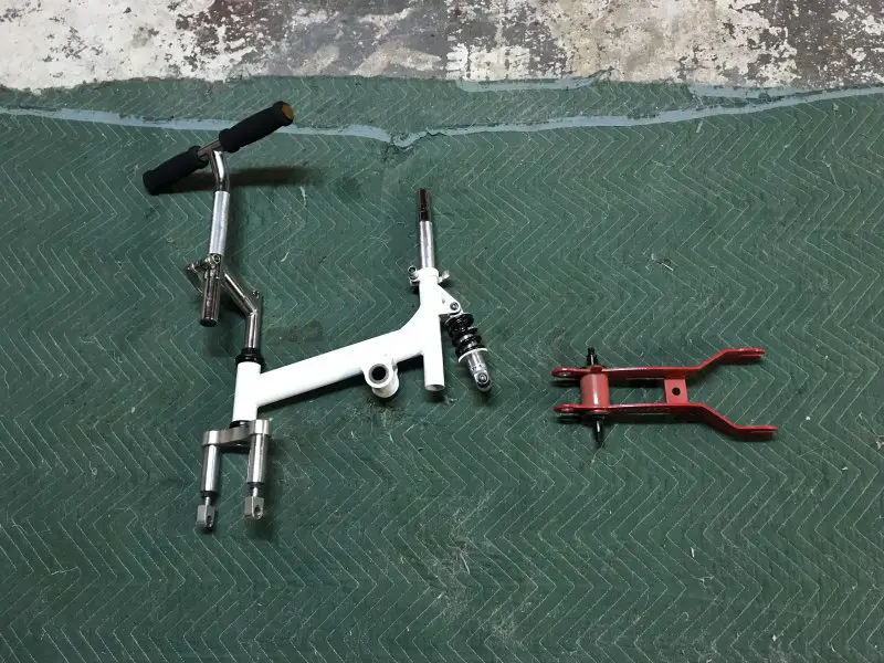

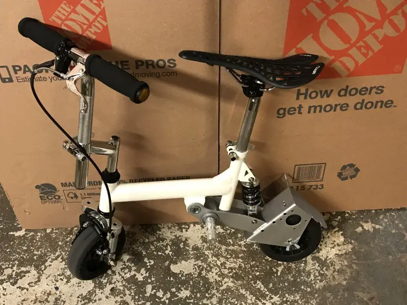

I been checking this website out for a couple of years. Discovered this website reading a thread from 2012 posted about a motorized clowns bicycle build. The motorized clown bike builds, built with Goped parts aren’t anything new, the tiny have been built for many years and are still being build by Goped riders. Sikk Toys built motorized clowns bikes, using Big Foot model parts. DIY builders use Goped Sport model parts. I have built several of the tiny motorized bikes over the years. I was about to start a new build July 2020. Was messaging on the 2012 clowns bicycle build. I was having a difficult time finding parts at the time. Had bought engine and other parts from DDM. Upon receiving the engine and parts, the FedEx driver left box sitting in middle of driveway at street and drove off as I walked out of house. The FedEx driver had been riding around with box in delivery truck for 2 days! When I picked up the box I had to grab the engine too keep it from falling out the bottom of box. The engine was damaged. I could see damage to clutch housing and fan cover, lose parts were falling out of hole in bottom of box. I contacted DDM, downloaded and printed out a return form and returned order to DDM. There response was there’s no damage to engine and no missing parts from box. The owner refunded my purchase price and black listed me from ever buying any part from DDM. He left me out the return shipping fee and no parts. When I replaced the DDM order I requested USPS or UPS shipping and I would pay shipping fee. Fedex has very poor service in my area and way too much damage. I was left with out the parts I needed to continue with the tiny motorized bike build and not able because of the owner of DDM.

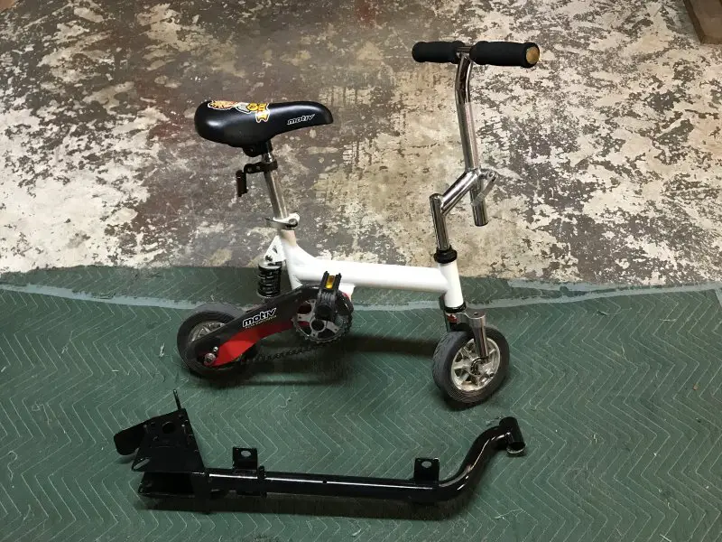

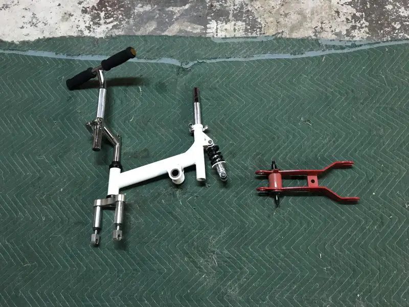

Now that things are a little more back to normal and I found Gomeye to obtain parts from, I’m finally getting started building a new tiny motorized bicycle. It’s very similar to the motorized clown bike build done in 2012. It a popular build with Goped riders and sell really well on eBay. Just doing a bas build using clowns bicycle and Goped Sport model frame. Little more details and pictures then the 2012 build on this Website. I’m using the same manufacturer clowns bicycle, it and the Runt clowns bicycle are the most used clowns bicycle.

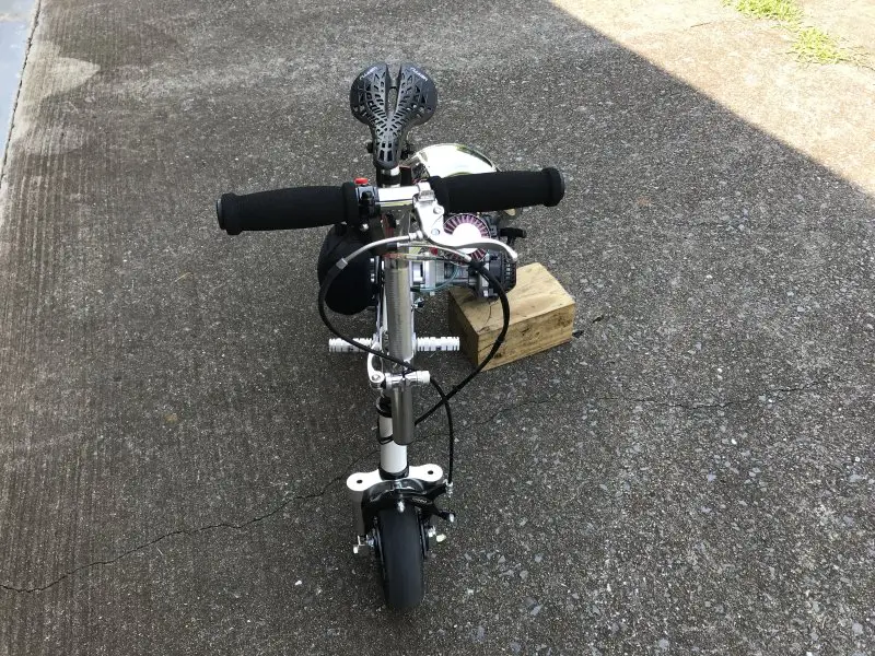

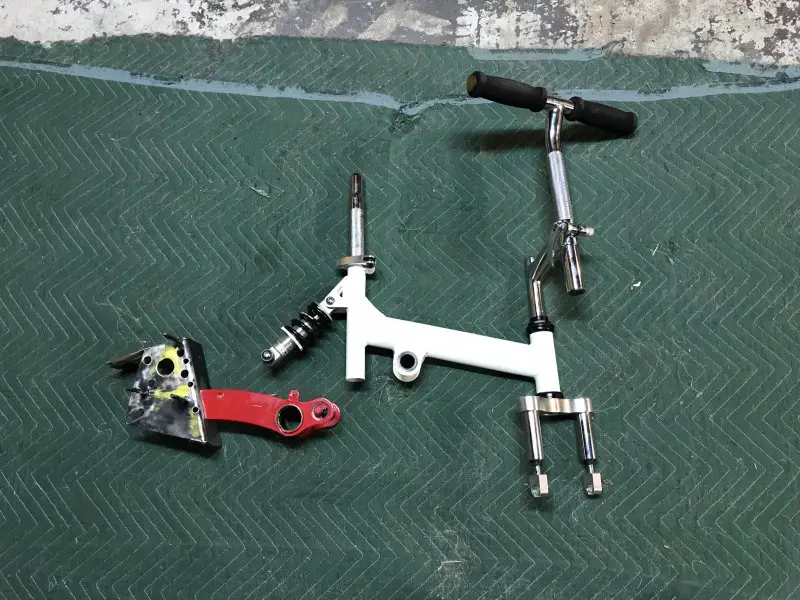

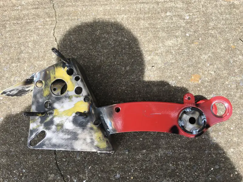

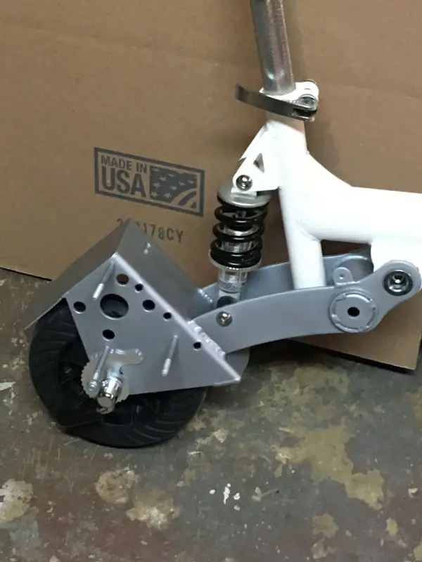

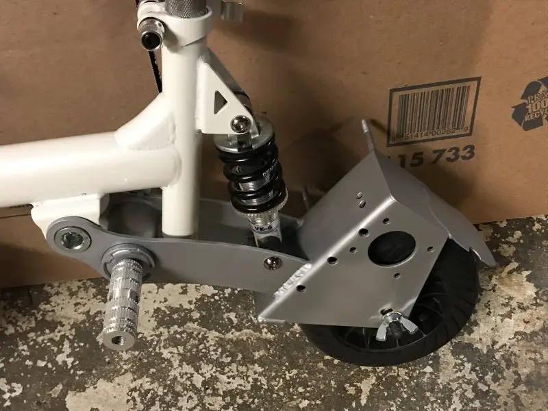

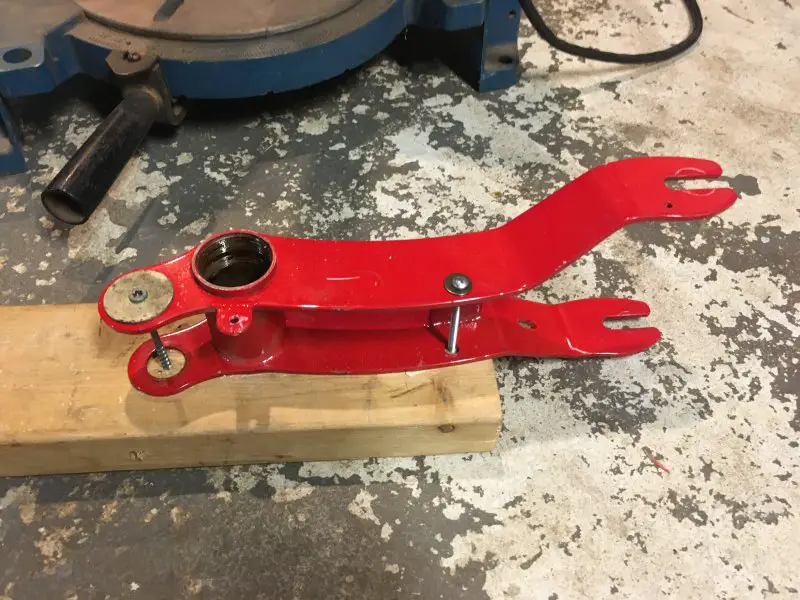

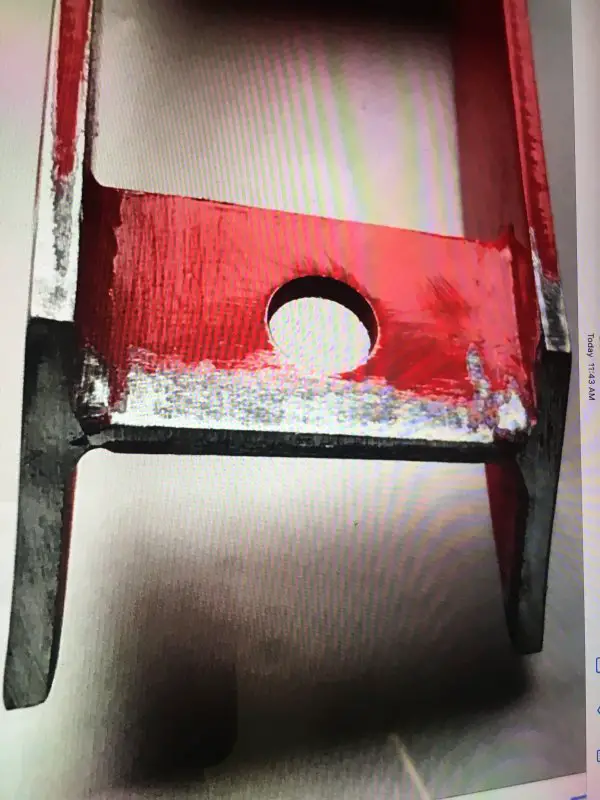

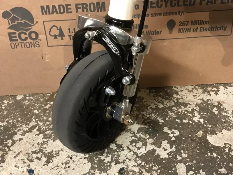

I search for the tiny clowns bicycle at thrift stores, Goodwill stores, and on eBay. Now days the clowns bicycles can be expensive, especially in good condition. When searching for a used Gopeds Sport model you have to be careful with your purchase. Kids are pretty rough on Gopeds. If you find a used Goped in good condition you can save yourself some money, To be honest I buy a used Goped frame and buy other parts new. In the end it ends up being close to the same amount of money, and you have all new parts. I buy very little or no Goped parts on eBay the parts ate priced too expensive. Gomeyer.com is where I been buying Goped parts. I bought the Goped Sports frame on eBay $60 shipped and cut engine box of and used a side grinder too remove frame tube and welding. Removed bicycle swim arm. Used cardboard and made templates of swing arm and engine box too work out angle of cut. Marked swing arm cut with template. I screwed the swing arm to a piece of 2x4 and cut angle with a 10” trim saw metal cutting blade. Made a perfectly even cut. I use a very good welder close to my house. He has made aluminum intake manifolds for Briggs and Stratton flathead engines I used on Rupp Mini Bikes. The forks need the axel bushings drilled out to accept a 3/8” bolt for Goped wheels. I found spacers at ACE hardware! Front brakes are just Goped Sports brake parts, bicycle caliber and lever work too. I used a bicycle brake caliper that was modified for Gopeds. Sold on eBay. Once the swing arm is manufactured and fork is modified. The Goped parts just bolt on frame.

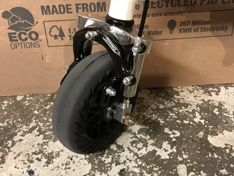

Throttle cable and front brake cable have to be made from Goped cables. This is where I’m at with build.

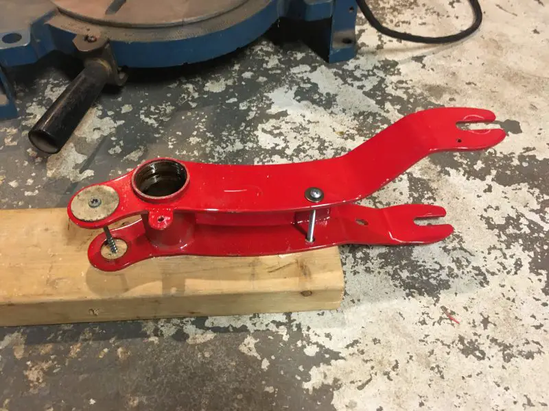

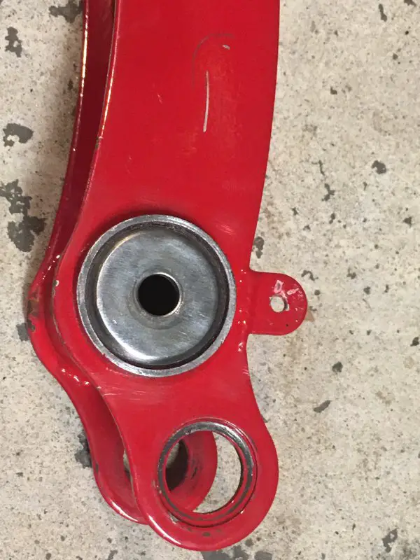

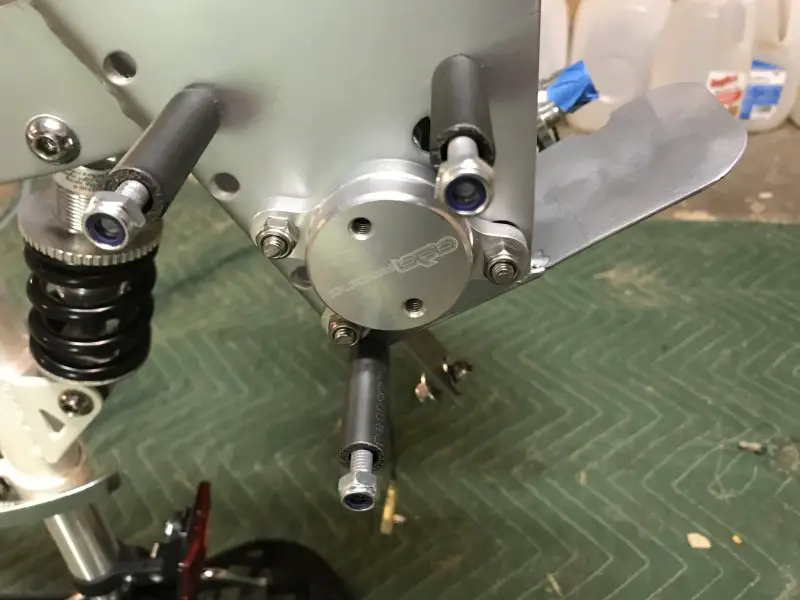

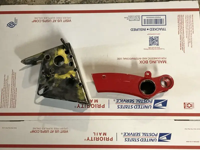

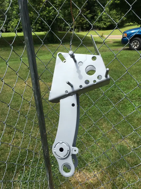

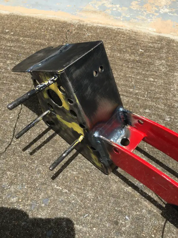

I used washers from Honda Civic shocks too cover peddle shaft bearings area, threaded rod and BMX bicycle pegs. I just used spray paint for car engines.

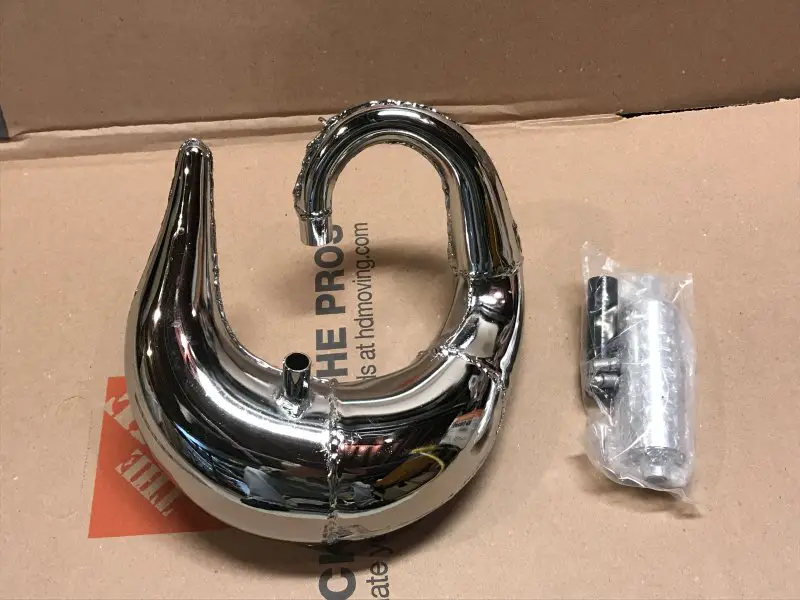

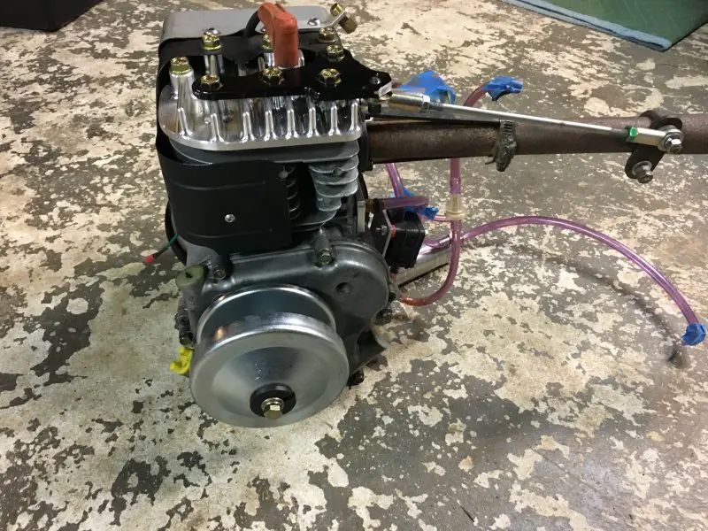

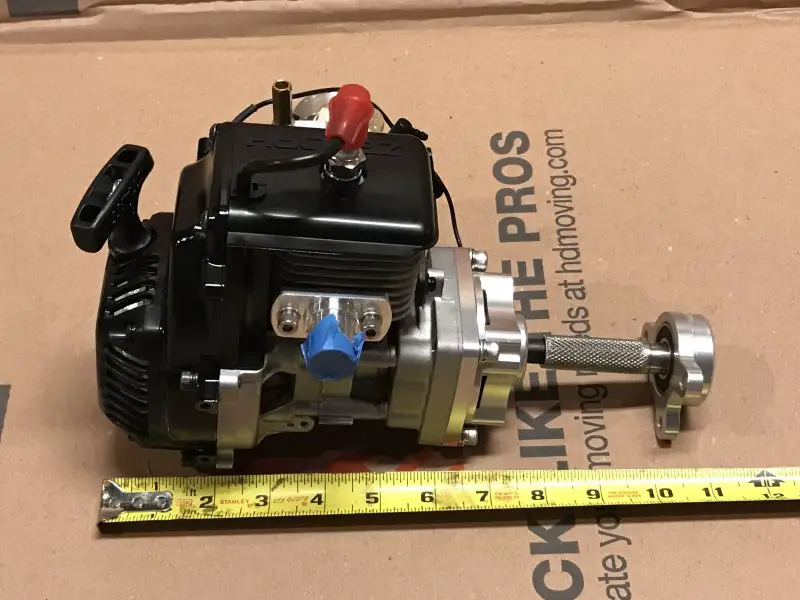

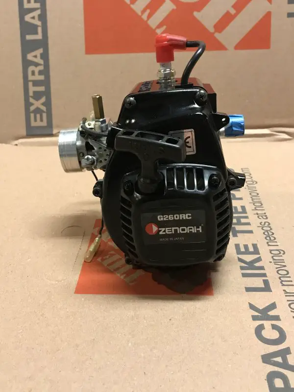

I’m waiting on some parts to arrive. A .650 long drive spindle, carburetor upgrade and linkage. Using a 25.4cc RC engine 3 horsepower 14,000 RPM. A Sikk Toys exhaust pipe.

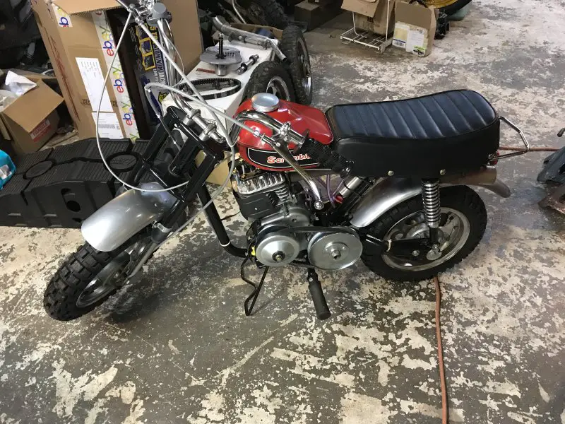

I was looking at pictures of Rupp mini bikes on some website many years ago. And there was a picture of one someone had built. Several people replied about bike. The owner didn’t give any details about the bike. One person ask if the owner would sell the bike and the owner told how much it cost to build. The person made a offer for the bike. I started doing some research and found some videos the guy who had the thread on this website in 2012. I built My first tiny bike from watching videos the reading the tread on this website.
The bikes are easy to build with basic tools. They are dangerous to ride, but a lot of fun to play around on. I ride the bicycles in the basement and driveway before I start removing the bicycle parts from frame. This build I had the clowns bicycle 1 year and rode the bicycle during that time. It’s strange feeling peddling and then having a engine. The feel and ride of bikes are completely different. With Goped tires the ride feels like you floating and has a lot better tire grip. For some information that could be benefit members on this websit, I was able to reduce weight by 9.3 ozs. Installing a Aluminum seat post and lite weight seat! Seat post alone was 5.8 ozs. Weight reduction! I’m waiting on some parts to arrive. Going to install a different carburetor and intake manifold. I have to manufacture a throttle cable and kill switch wire. Be next week before I receive the parts. Hope you enjoy the build.

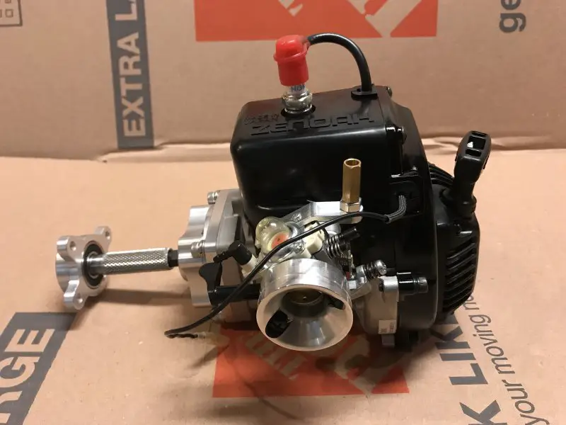

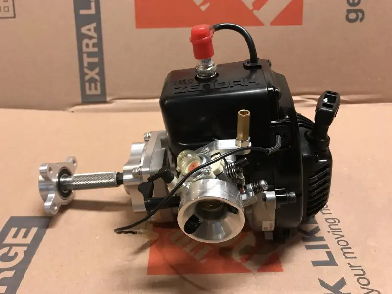

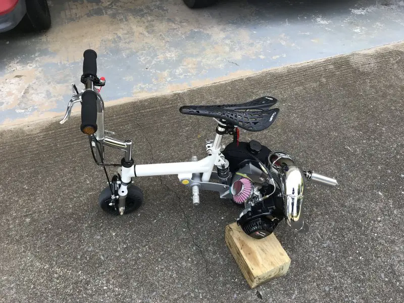

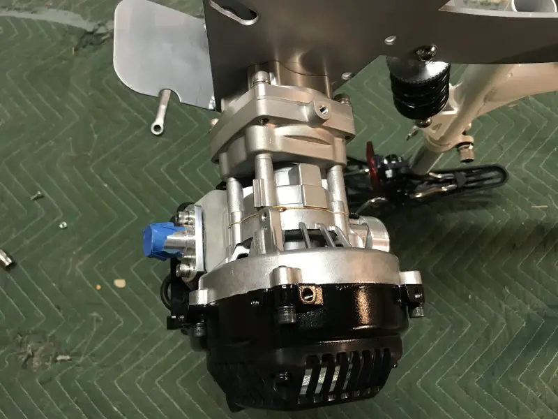

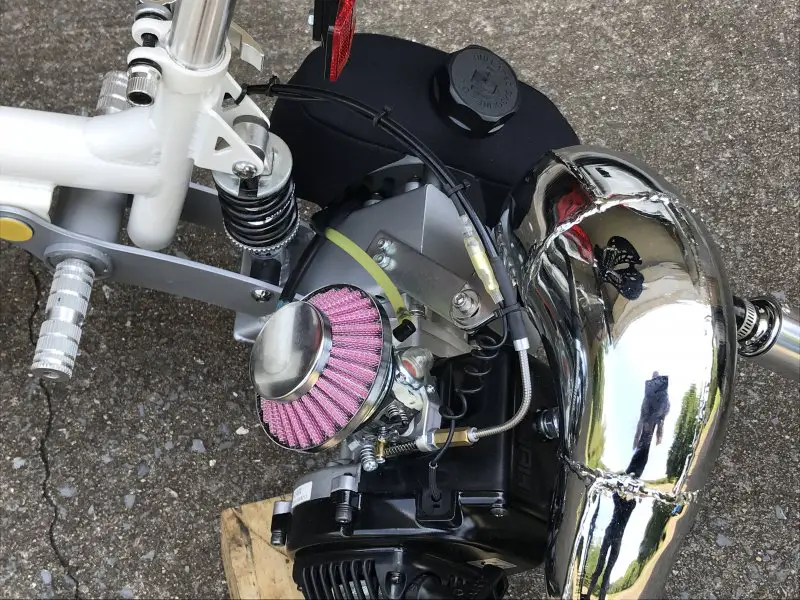

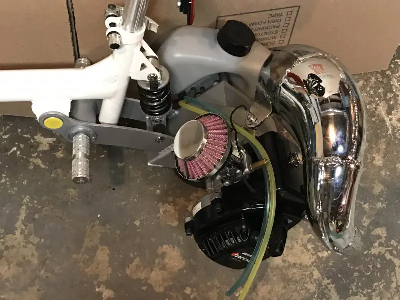

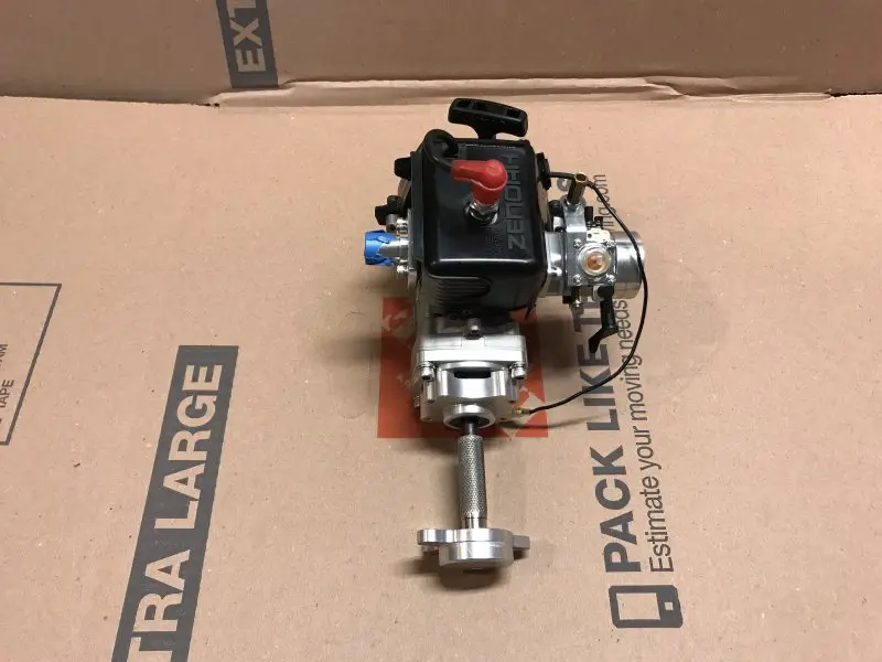

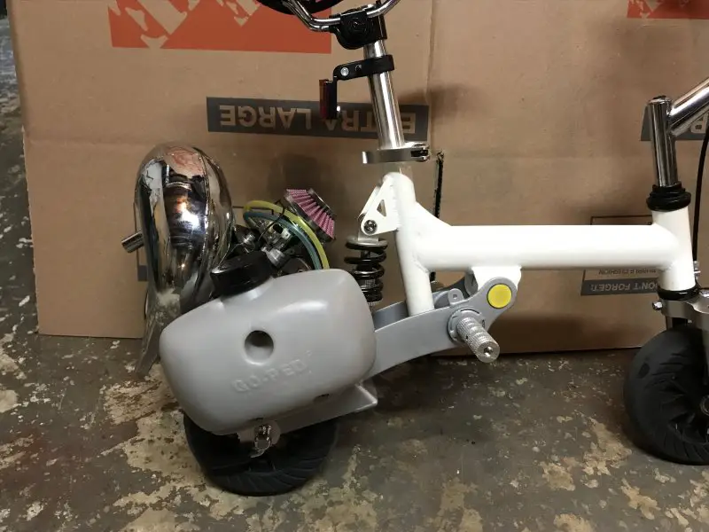

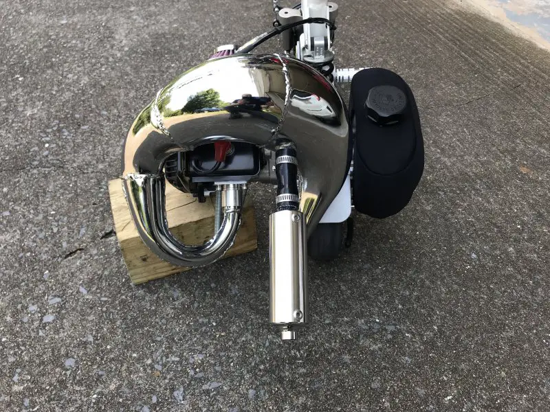

Parts arrived. Have the parts installed on engine. I installed,
ADA racing Tall billet intake manifold
ADA racing Velocity stack
ADA racing clutch kit
ADA racing long drive spindle
ADA racing 3 bearing kit
Heavy Duty throttle linkage kit
Walbro 668 carburetor
Goped factory kill switch wire
SIKK TOYS billet exhaust manifold
The engine is a ZENOAH G260RC 3 horsepower 14,000 RPM
Exhaust pipe is a SIKK TOYS

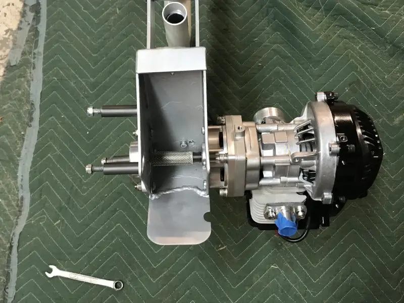

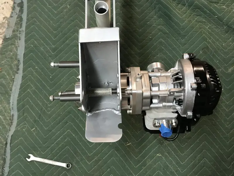

Engine and 3rd bearing installed.

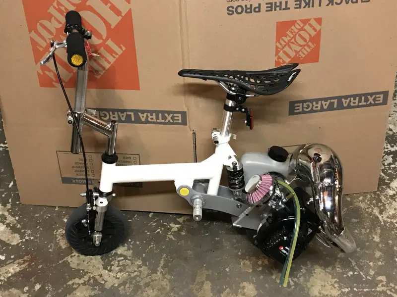

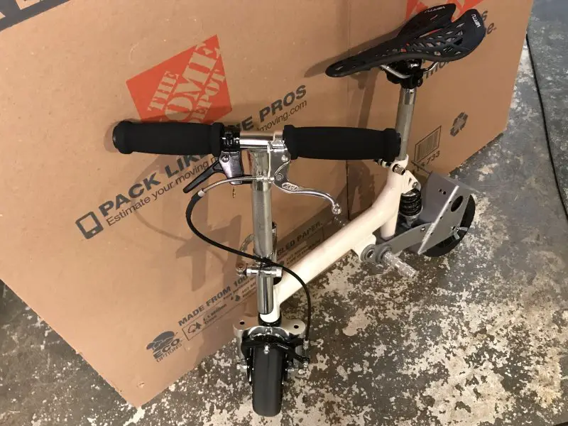

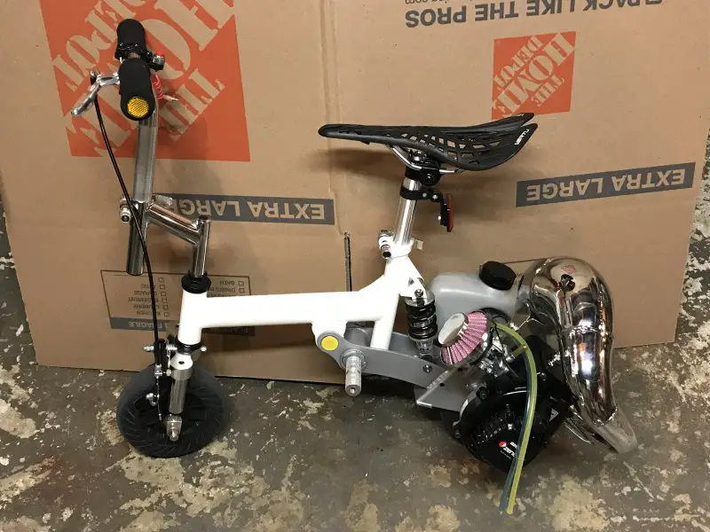

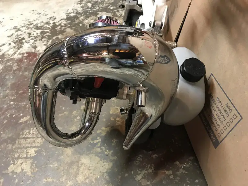

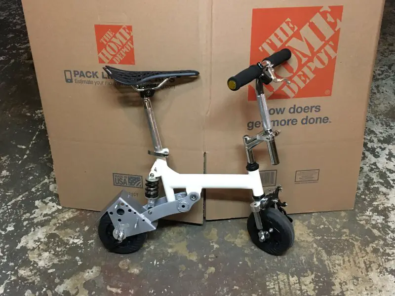

Got bike put together. I’m still waiting on a swivel too attached throttle cable too carburetor. Should have arrived yesterday! Have to make a throttle cable and kill switch wire.

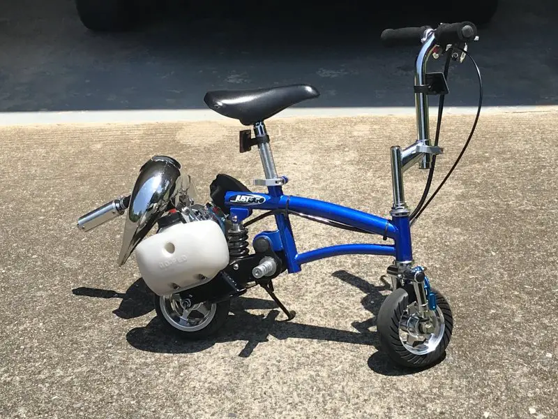

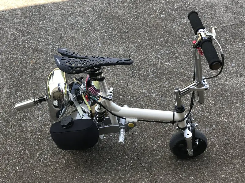

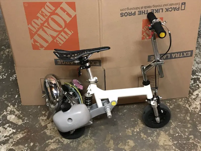

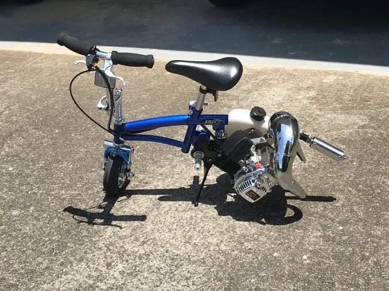

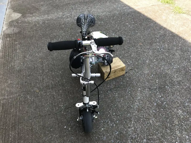

I still have to manufacture a kickstand for bike. Haven’t started engine yet. Have to buy gas. Bike is finished.
Weight 26lbs.

Yes I have ridden the tiny bike 3 times, in the street in front of my house. It’s fast, will wheelie with touch of throttle. I have to build up speed slowly not to wheelie. It has a small drive spindle but will still do about 30 mph. What you see that you’re thinking is a gear box is a ADA racing external clutch housing with clutch bell. No a gear box. When the engine reaches the power band the RPM takes off like a rocket. It’s a handful to handle when it gets up too speed. I’m small 5’4” 110 lbs. so it picks up speed quickly with me riding it. I’m going to do a video of me riding it, but haven’t got around to making a video yet. I’m don’t want to crash or get hurt doing a video. Have to get my girlfriend to do the video for me. Been thinking about making a wheelie bar for it. Thank you for the interest. Haven’t been on here in a while been working on my 1988 Yamaha DT50. I installed a race spec engine I had Team Calamari Racing build for me.

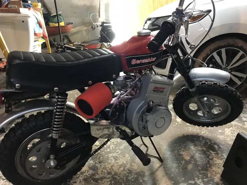

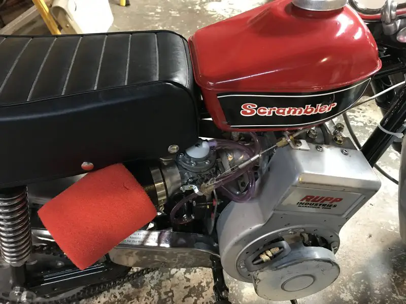

The Rupp Scrambler mini bike I built had unreal horsepower with the Fred Craw Racing engine. He builde JR Dragster engines. As soon as I touched the throttle the Rupp mini bike would start to wheelie. On grass the tire would dug down too dirt and wheelie. On pavement the Rupp mini bike would wheelie. It was difficult to get it started without a big wheelie. I had the 3 piece 10 inch wheels that weren’t very true, so it was impossible to reach top end speed, it wanted too wheelie and create tank slapping! Was just too powerful too ride. I parted out the Rupp mini bike and sold it on eBay and made money! I still have the Fred Craw Racing engine or a future project. I attached pictures of Rupp mini bike and the tiny motorized bike the 68 years old man in Florida bought. Thank You for the interest!
