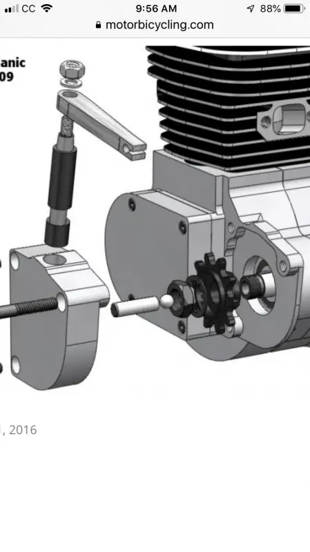

So you’re saying the cable is slipping in the lock collar? Try greasing the clutch arm, bucking bar and ball, they sometimes have no grease when delivered. Also put a small amount of grease on the teeth of the gears on the right side as well.
This is the area that needs grease.
