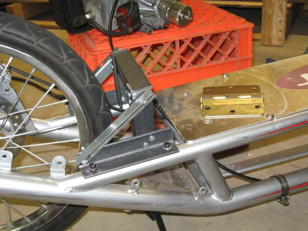

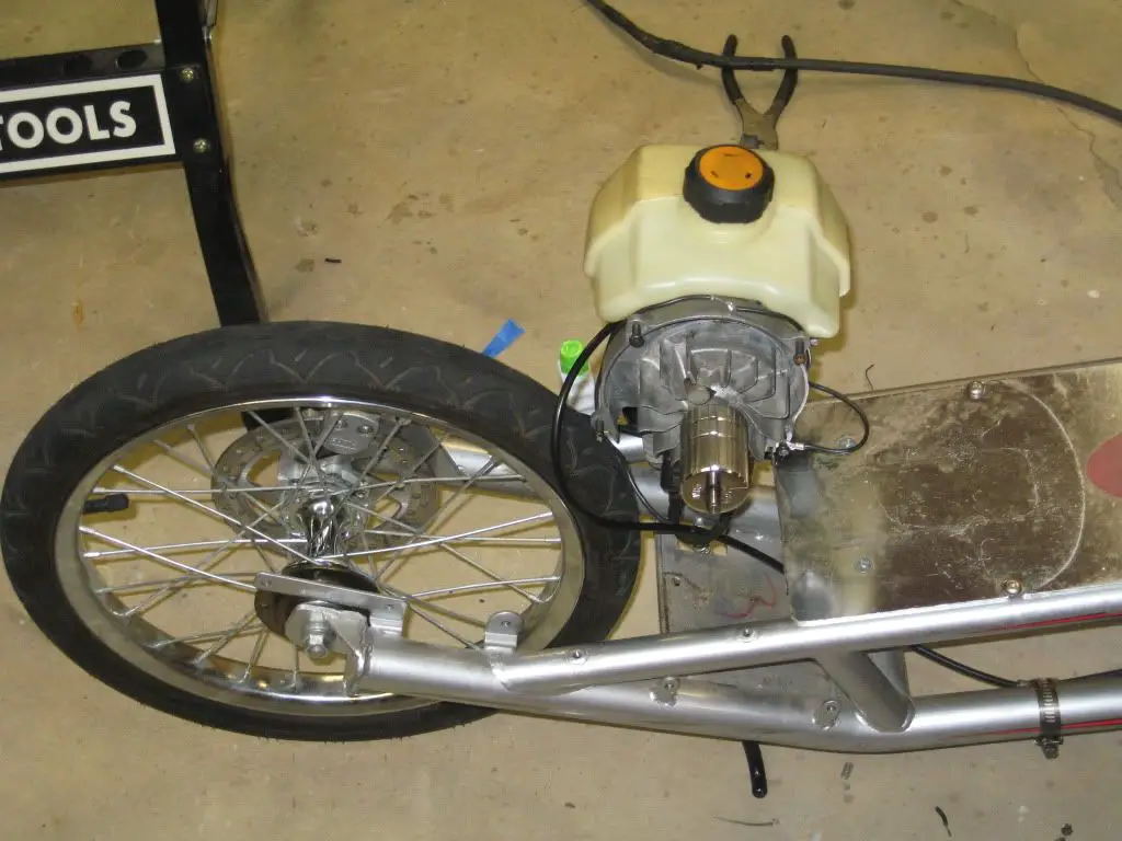

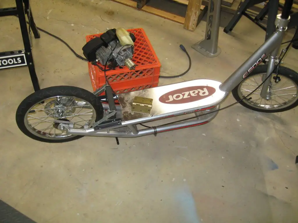

My friend gave me his razor e-500 electric scooter a little more than a week ago and I got bored with the low range on the electric. With the good brakes and solid frame I decided it would be GREAT for a friction drive, and an added plus, there were four threaded holes where the fender was so that's what I attached my lower mount to.

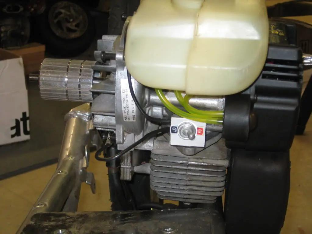

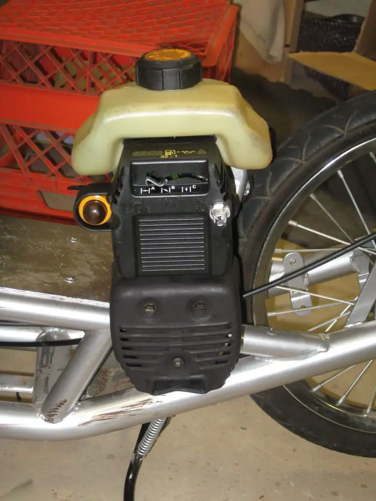

My power plant is the good old 31cc ryobi, much loved by home builders and friction tinkerers. I cleaned it up really good and made a kill switch mount for it. I also removed the racheting mechanism in a spare grip shift I had and I used that as the twist throttle. The little return spring on the carb was not enough on its own, so I took a governor spring from my HF engine, drilled a hole in the air filter housing, and held the end with a brake tensioner and a little clip I made from a nail.
Up until this point the project was free, but when I went to buy flat stock and angle iron for the engine mount I was ROBBED. $22 for 6ft of angle iron, and $11 for 4ft of flat stock....poo....still, it's worth getting good mount materials.
tomorrow I'll use what I have left to make the engine portion of the mount, and I'll connect it all with the door hinge I've been saving. There will not be a "clutch" on this like some people have but I am not mounting it solid so there is less stress on the shaft on bumps. I'll keep you all posted. Enjoy the pics!
