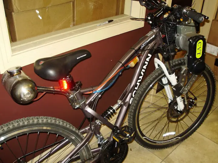

I put one on as a front wheel drive on my 29'er. Just got back from the races with it. Did about 8 full laps of the Grange breaking it in & adjusting the mixture. Engine had 5 minutes on it before it hit the track.
Then it was two 6 lap heats & a 10 lap main - mostly at WOT. Never missed a beat. Going to be a good commuter.
It pulls pretty good for 48cc's - and 220 lbs on a 29'er
I need to tune the CVT a little. The clutch stalls at about 5200 rpm, and the CVT starts up shifting about 5500. It would have more punch if it started shifting about 6500. The engine is happy at 7500.
Right now, about 27mph on level ground without pedaling. Should improve with some changes to the CVT.
Like I said, with a shift kit hooked to the end of the standard 5:1 pocket bike transmission it should be a runner. There was just no room for that with full suspension.
