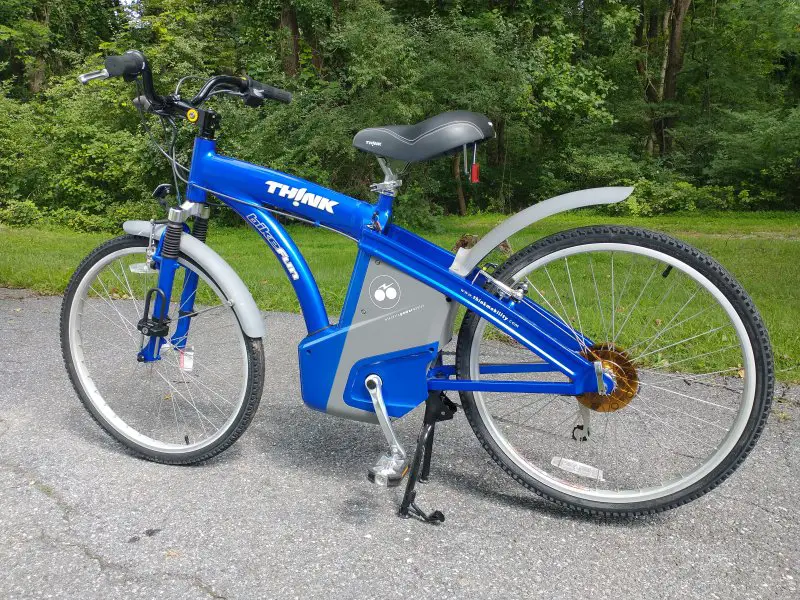

I bought a Think Fun today, NOS, never been ridden.. original owner ordered his and hers, but received two "his".. I have a copy of the owner's manual he gave me, and I will be happy to scan it for you.. Dave Scrivener, MotorWeek TV
