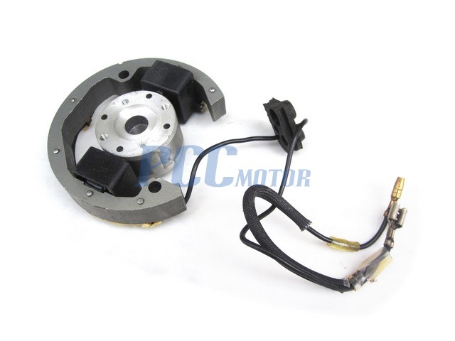

So after ordering my third magneto since I've started riding this bike, I have decided to try and make them last longer, granted it's been an acceptable cost at $25 a pop, and I've ridden many miles, but the mag coils shorting out over time from heat is a systemic problem with KTM50's so I think there must be a simple solution.
Here's the mag stator with two coils, it sits inside a plastic cover, which I have drilled for venting at the front and around the periphery by the coils, it has helped some, but when a mag goes out it makes the bike run all weird, do crazy stuff, and bog under load or high rpms, altogether a pain experience because it makes you think something else is wrong.
I figure some fancy heat shielding should help to keep the stator cooler, heres the stuff we use to protect electronics and CF tubs on race cars at work, I was able to get a small scrap of it today for the mag.
I'm going to wrap the engine side of the stator with this, around the plastic potted coils completely, and maybe install it with nylon bolts vs the stainless ones on there, and use a ground strap. I'm also thinking the mag might last longer with a resistor inline with the kill switch circuit, to prevent the coils from flowing a lot of juice that would normally not flow continuously when charging the CDI and pushing it through a high resistance spark gap. I like to reve the bike and let it ovverrun to burn off the fuel and oil on the plug before shutting it down, and it may lead to too many amps going through the mag when doing so. The major killer is engine and clutch heat for these, as stated on KTM50 forum threads, but the current flowing through the coils can also generate internal resistive heating that eventually breaks down the enamel on the wires and causes the coils to lose inductance, which leads to loss of CDI charging capability.
It's worth a try anyways, and this gold heat shield is only $20 per square foot, so I might buy more in the future for other things like this. I'm thinking about probably putting some on the engine facing side of the CDI too, because it too contains inductor coils which can break down due to heat from the jug.
I wrapped my new magneto coil and my existing CDI and went out for a ride today. I can get all the revs again without it bogging or doing funny runaway revving crap, yayyy!
