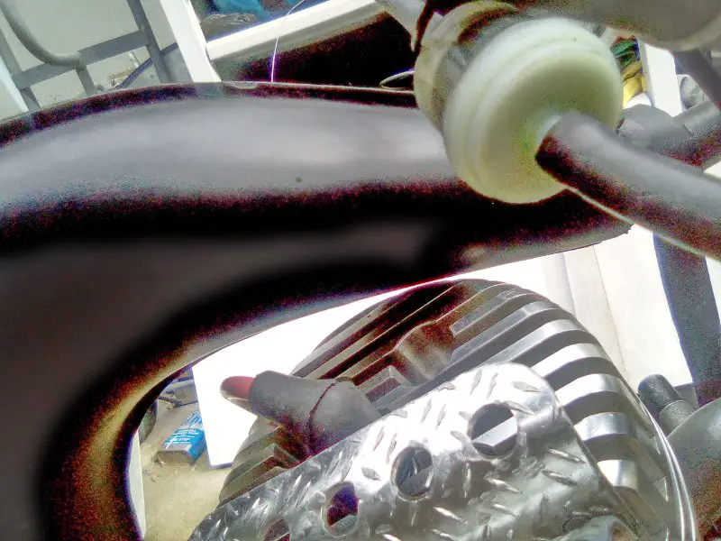

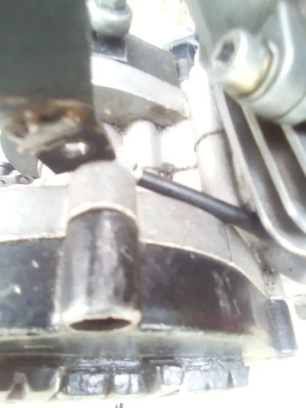

The thing to be aware of is that it might not fit on all bicycle frames and May getting in the way of the pedals or the front wheel. This is a very very common problem with most people that purchase this without any knowledge of how they fit.
Mine barely fits on my ld100 without modification to the case strap and is almost touching the aluminum CNC head that I've placed on top.

Keep an eye on the spark plug color!!!
Re-jetting the carb is almost always needed when you install a new pipe.
