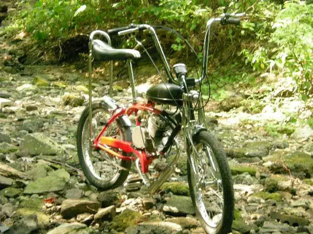

HELLO IVE FINALLY DISASSEMBLED MY BIKE TO I QUIT RIDING IT EVERYWHERE. MY ORIGIONAL DECISION WAS TO MOCK UP MAKE SURE IT WORKED WORK OUT ANY KINKS AND TEAR DOWN AND PAINT BUT I JUST KEPT RIDING AND RIDING AND 160 MILES LATER I FINALLY MADE MYSELF TEAR IT DOWN.
THIS IS MY BEFORE PIC BEST ONE I HAVE

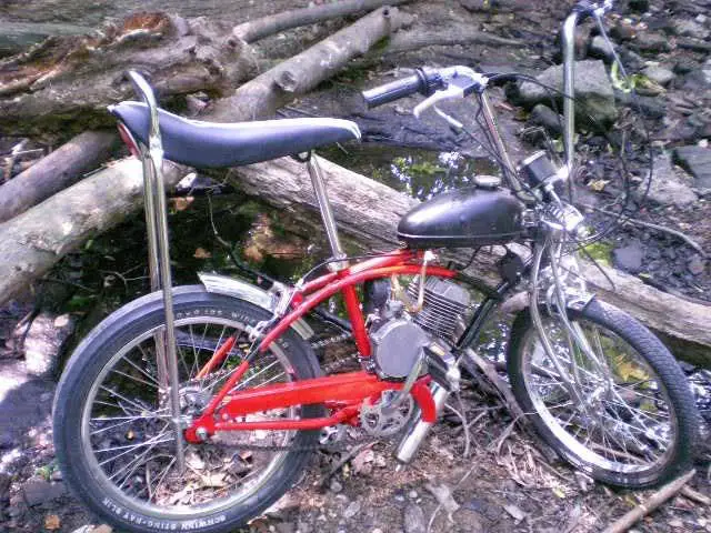

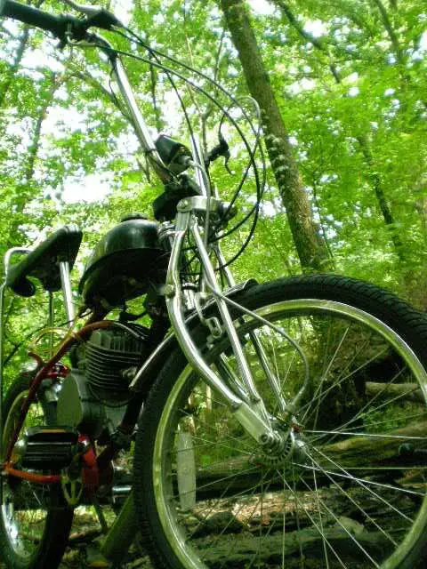

HACKED UP THE REAR TENSIONER AND WELDED IT IN LINE WITH THE CHAIN LINE.
USED AN OLD CHEVY OIL DIPSTICK TO MAKE A PATH TO FEED THROTTLE CABLE THRU TOP TUBE.
TRIMMED CHAINGUARD TO CLEAR ENGINE
DUAL PULL BRAKE CABLE CUZ ONE BRAKE JUST ISNT ENOUGH AND IM TRYING TO PULL A ITS FACTORY AND IT SHOULD LOOK THIS WAY LOOK.
ALSO I HAVE A 27T SPROCKET FROM KINGS SALES AND SERVICE. GOOD FOR 35+_ ON MY 20" TIRE
AND I HAVE A SCHWINN 5 SPEED SUICIDE SHIFTER IN GONNA MOUNT ON THE TOP TUBE WHICH MAKES ME NEED A NEW GAS TANK IDEA. PROBALLY GONNA DO A CHOPPER OIL TANK MOUNTED TO THE SISSY BAR . ANY ONE ELSE GOT ANY IDEAS. LET ME KNOW
