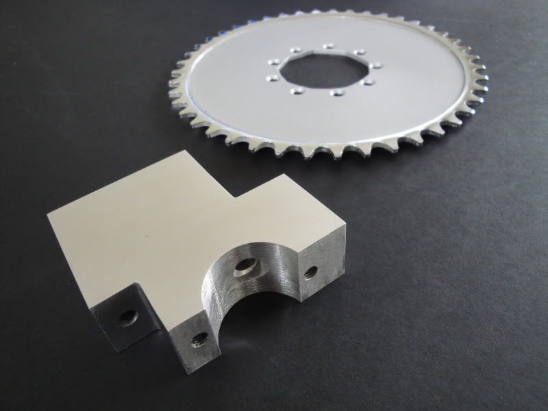

Thanks for the info.
But if I mount the chain wheel like this (pic) the chain wont clear the tyre and the bolt heads would catch the coaster arm. Also the chain wheel doesn't seat very well over the bearing dust cover, if I take the dust cover off it seats very well but obviously the chain would realy eat into the tyre.

You must keep the dust cover on & drill the center hole in the sprocket as large as possible & bend the brake arm into a 'Z' shape; & then add another rag joint to get the sprocket out far enough.
Or you can simply purchase a 'Sportsman' hub adapter & sprocket. The sportsman hub adapters are taller that the other brands to allow the use of large 3" tires. You will still have to keep the dust cover on & bend the brake arm though. ;)

I see what you mean about the brake arm, but what is a rag joint and if I make the hole in the chain ring bigger it will sit over the dust cover and closer to the spokes.

The rag joints are those two big black rubber donuts that go between the sprocket & the spokes... & you make the center hole big enough to almost touch the 9 smaller holes.
