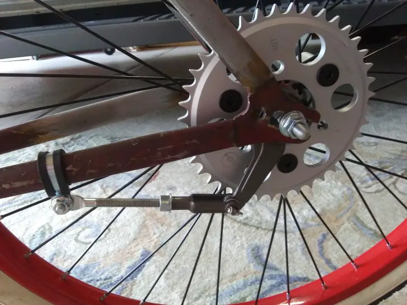

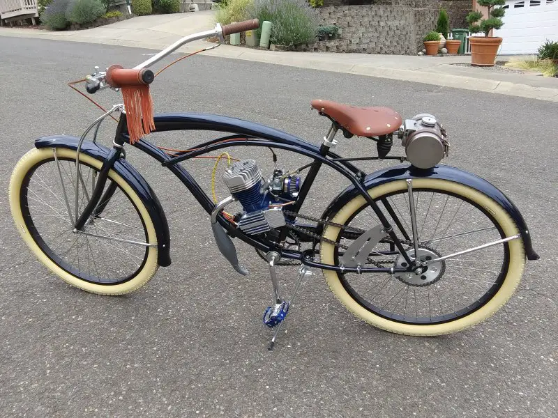

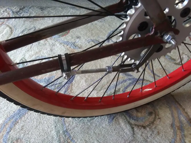

Well I got this Idea from Jeff Wolf a couple years ago and had to incorporate it into the build. The threaded rod connected to the Clevis Joint is off a satellite dish I took off the roof, then I drilled out the Clevis joint with a 7/64" bit then tapped it out with a 8mmx1.25 tap, Brake arm was bent inside and out then welded where a shallow channel cut was made for the bends, Shimano CB E110 brake with a 40 t sprocket. Everything clears Everything well so far now to engineer a Chain tensioner ? was thinking of one of my Designs like this that I made for Ol' Blue HUMMMMM? (Last Pic)

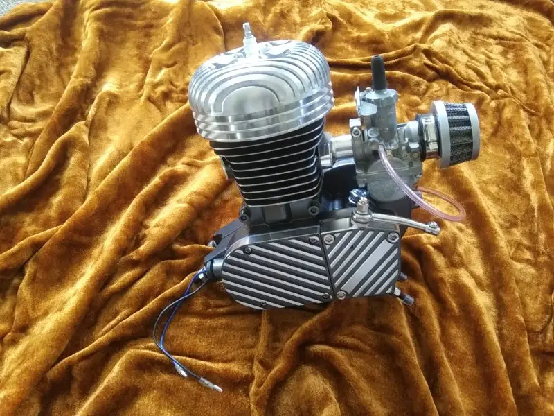

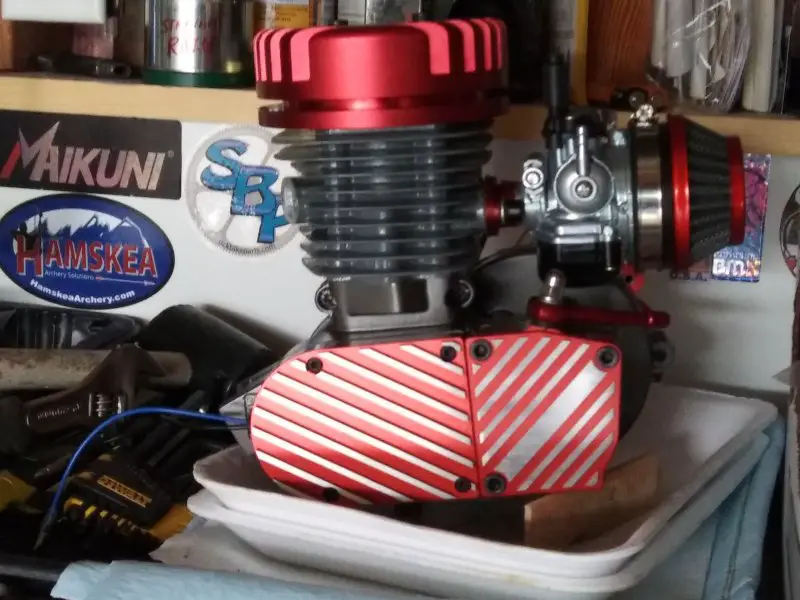

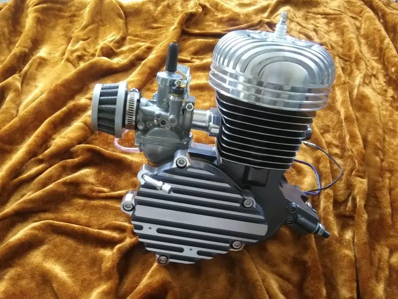

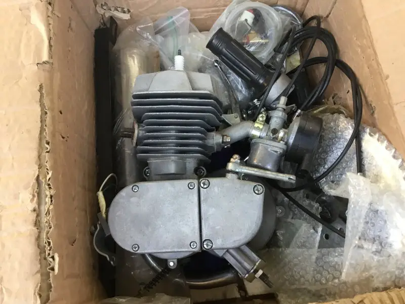

Been busy building a couple of engines to help with the funding of Super Bad.

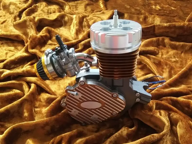

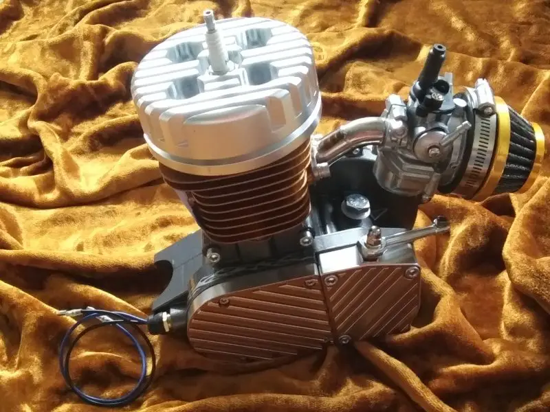

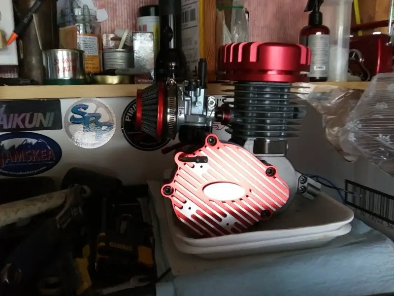

Got some engines built to help fund the build and also did a rebuild and update on a 17 yr. old engine for Curtis Fox I'll probably finish it tomorrow right now its mostly just test fitting

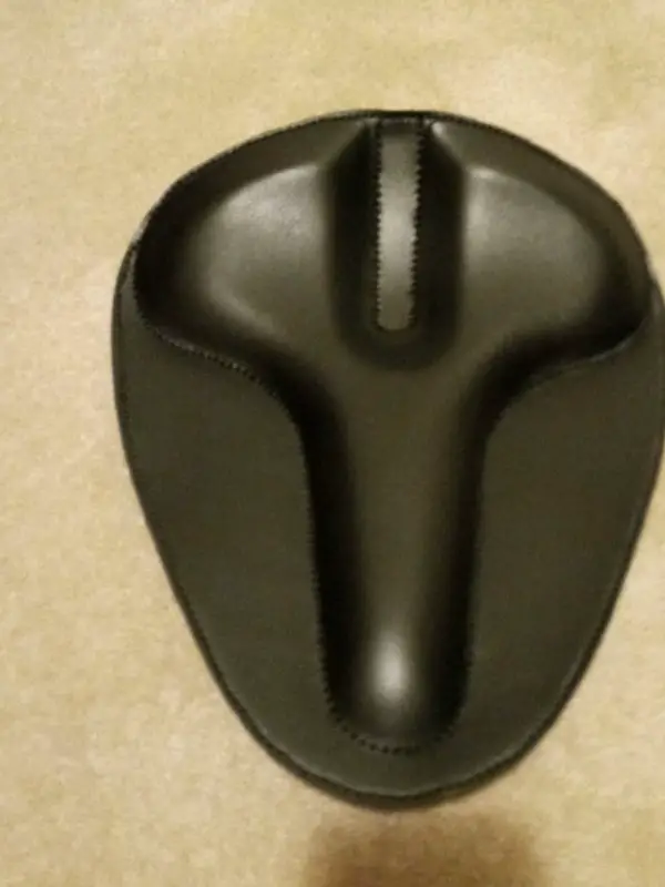

A little off subject but I just got this BTR Saddle from a Good Friend in Thailand , it's not leather but that keeps the cost down .
