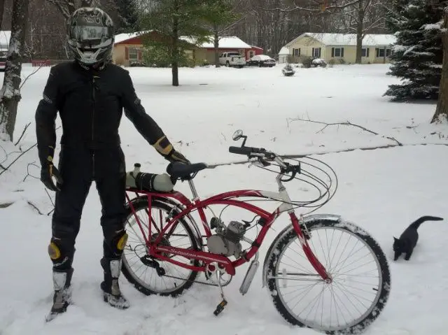

Here's a photo of mine. Taken about a half hour ago on a test ride. I'll be doing more of that, more loaded down, here shortly.
Studded tires, front and rear. It doesn't go through deep snow, or deep auto tire ruts, really well. But slush and shallow hard pack on the roads is not a problem at all.
I've got my windscreen/bar mitts adjusted about as well as I think I'll manage. And it's good. I've already been out in wind chills of ten below and I was comfortable.
I should have gotten a pic of me in my winter clothes. They're not too different from yours.
It would seem to me that wider tires would be in order in snowy climates. Much wider. Like the ones I'm putting on my next bicycle. Just trying to keep it "All Weather All Terrain Real".
And those aren't midget feet in the picture either. LOL

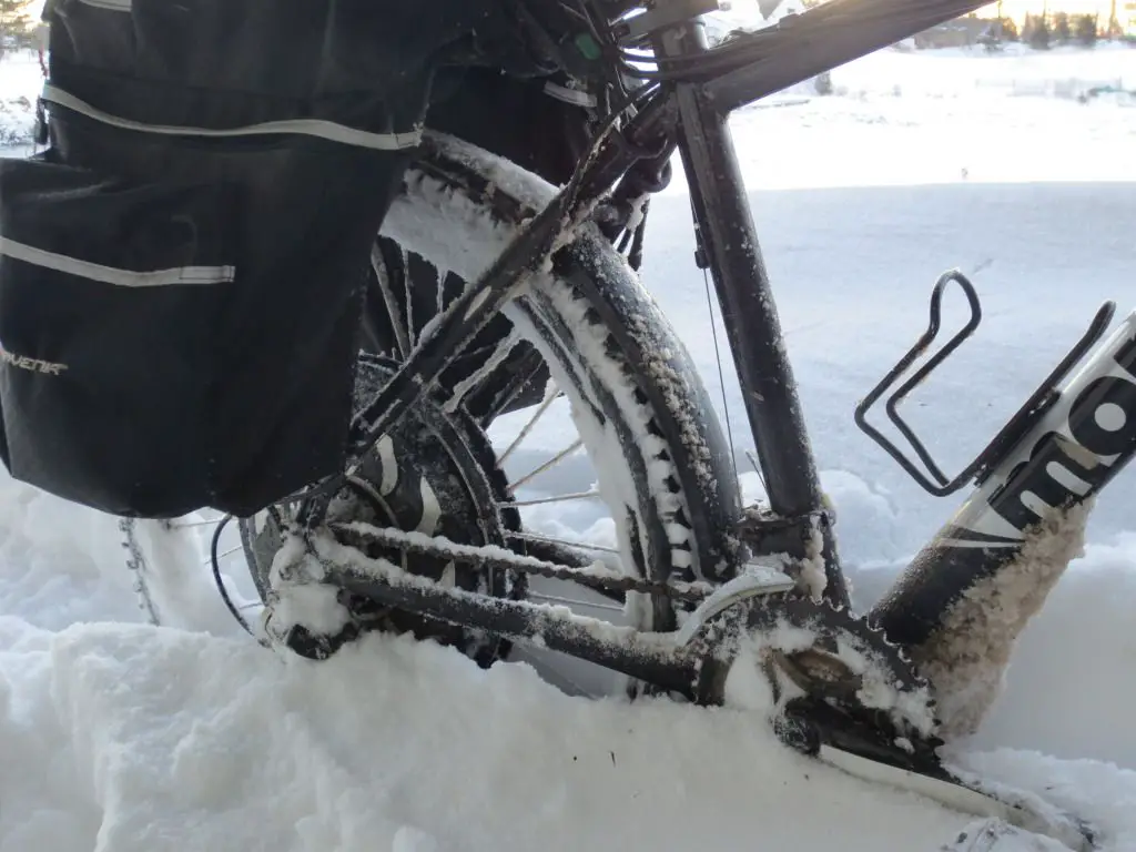

Not true a tall skinny tire will cut through way more snow then any wide tire. Back when i had my Modeel A with 19" nobbys i could got through 2 feet of snow. and i do remember the fun it was to be able to do that as a kid.wide tires act as a plow need a lot of power to push............Curt
Not true a tall skinny tire will cut through way more snow then any wide tire. Back when i had my Modeel A with 19" nobbys i could got through 2 feet of snow. and i do remember the fun it was to be able to do that as a kid.............Curt
Try maneuvering and stopping in the snow and or ice at a speed greater than 10 MPH on bicycle tires and you will literally be taking your life in your hands. Especially if approaching a stop light or stop sign on a motor powered bicycle with bicycle tires on it. That's not a rumor. It's just simple physics. LOL
The contact patch with the road from a bicycle tire will get you killed at speed in adverse road conditions. It's not a matter of if, but only when. The faster you go, the wider that patch has to be, especially when stopping. That applies to anything with tires on it.
I used to ride an old racing bike to school through the winter. The thin tires sliced through up to around a half foot of snow and minor drifts very nicely.
Heh, just remembered before hitting post, it was a "Tigre of America" 21 speed, of which as many as 3 worked at any given time.
What size & type of tires used in adverse conditions is and has always been a hotly debated topic, I for one prefer a narrower knobby tire with lots of small lugs spaced somewhat far apart for the icy snow type stuff. As CTripps mentioned, cutting through the accumulation instead of trying to "float" over it.
It's tricky, each different surface really does require something different from your tires - but it's more the bottomless sand, mud & glop you'll find off-roading that the big floater tires excel in, if you can cut to the bottom then you're usually better off with diggers (classic off-roading philosophy, debated nonetheless)... making it even more debatable is it all depends on the vehicle's weight as well, there's little point in trying to make a tank float lol
In fact one of my own personal particularities is I don't bother with studs in bicycle tires - while I don't advise against them (get 'em if ya can), in practical everyday application I've found there's just not enough weight on the contact patch to have them cut in, the perfect glare ice they might help with so rare it's just not worth my effort/expense... and that lack of contact pressure would be only made worse w/floaters.

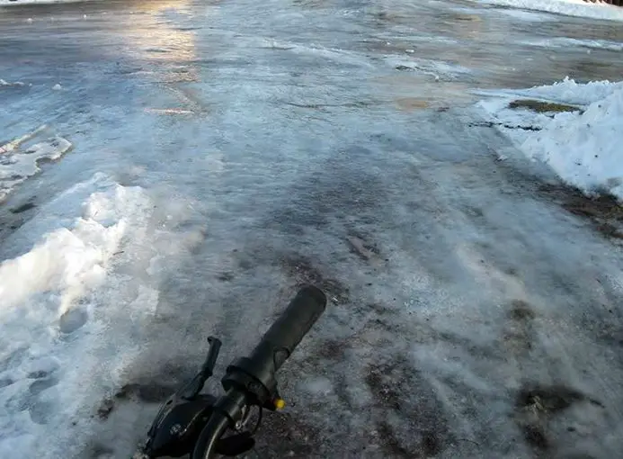

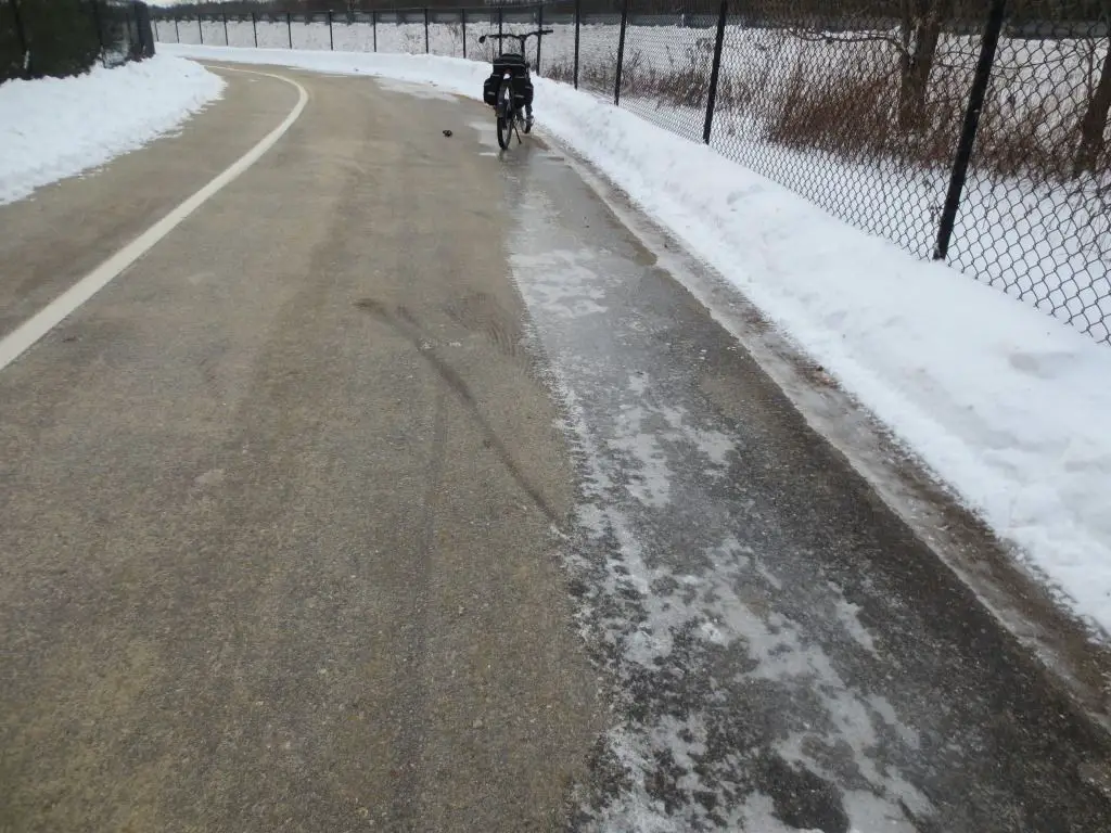

I do agree to a large extent, I've had occasion to regret my lack of studliness lol - note the tell tale skid in the first pic, not shown is the sidewise cartwheeling crash a split second later;
The second pic was a rare but interesting event, interesting in that due to the hard to see slope folks couldn't walk it very well, let alone drive a car on it as they'd slide sideways down the hill - I only made it across by straddling the bike & using it as a walker *shrug*
...but again, while I do reco to others to stud if they can, 'round here it's dry or it's crust, drifts & storms 99% of the time so it's a calculated risk to run w/o and it's been worth it...
...mostly :p
Yes. That second photo, in particular, looks scary.
