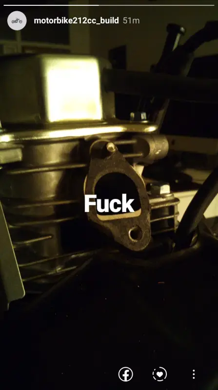

Throwing down some root beer, with some whiskey, tryin pull this bolt off, and the head snapped off. I tried the bolt to botl trick but my wrench is to big. Any ideas

That should come right out with some vice grips. If it's really stuck, pb blaster it and let it sit while you finish your drink and then pull it out.

- i have 2 bolts but my wrench is to fat, i ordered a thinner craftsman wrench for like 7 bucks. im going to try the bolt trick with smaller wrench, it worked before so, well see. if not i may just leave it, throw a nut on it. then when i go to the weld shop in the near future for a legit welded elbow pipe set up, im sure theyll have the right tools to use and not angry whiskey strength

Grind flats on the last 1/4” of it and grab it with vise grips or a wrench.
Put a 5/16 or 3/8 nut over it, weld in the center and use a half or 9/16 wrench to remove it.
Tighten two nuts against each other and use them to back it out.
Cut it off and use a left hand drill bit to drill it out.

going to try the 2 bolt trick. yeah idk, i enjoy a good beer and some food cart tacos every now and again
Last time I had to remove a broken stud (broken off flush) it took me ten minutes or less.
It's been four days, man. Grab that thing with vice grips and twist it out already.

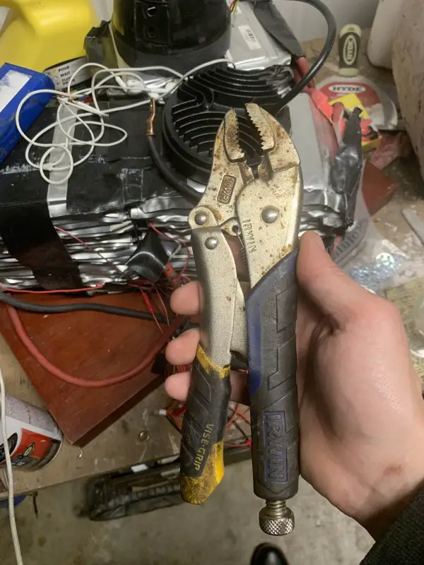

yeah i dont have vice grips, and the thing is dead stuck on, i dont think vice grips would do anything but strip the bolt
