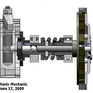

Thank you I'll give that a try right now. Would you happen to know why my bucking bar won't allow my clutch cover to go on all the way? I have both old and new bucking bars the old one will fit just fine and I can still engage and disengage the clutch but not all the way I've tightened up the clutch cable as much as I can without letting the clutch lever slap the carburator.
With the new bucking bar the entire clutch cover assembly is almost a 1/4 of an inch away from the the mounts.

Thank you I'll keep that in mind. I'm still currently in need of knowing what the problem is with my bucking bar. The clutch cover is completely off along with the flower nut and the bucking bar just will not go in all the way.

The bar protruding too far indicates to me you need to tighten the flower nut some on the clutch plate, this will make the clutch engage crisper too.

As you tighten the flower nut it compresses the spring inside the cases and pulls the bar deeper into the cases.
