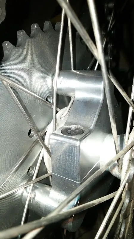

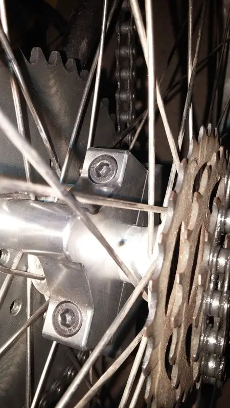

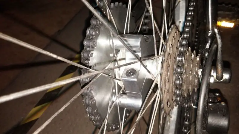

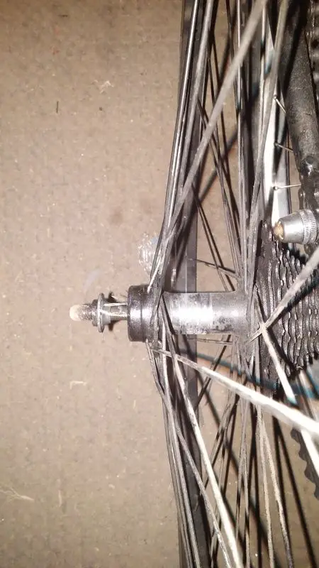

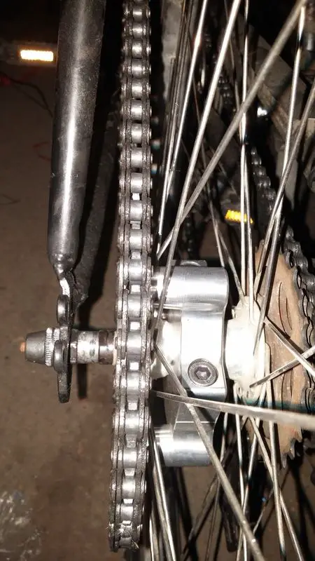

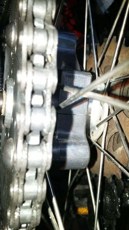

Okay heres some pictures of the wheel currently this new hub seems a bit better then my old one. I'm pretty sure its installed correctly.

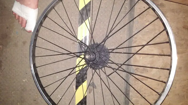

Heres what the old rim looked like its a lot more warped then the pictures show.

I'm going to watch it closely it feels super tight if it moves again I may glue some inter tube material to the adapter, what would ad like 2mm.

I can see its already moved from my last ride that was only about a mile I believe it will need shims after all.

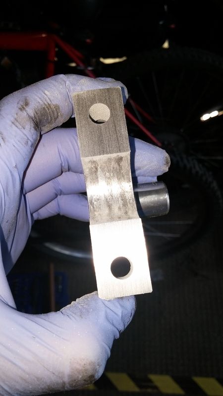

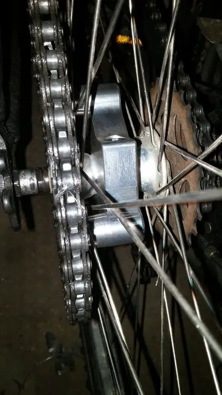

So I went ahead and lapped it today with sandpaper on my plywood work bench, I didn't care much to how perfect it was just needed to remove roughly 1-2 mm of metal. It came out great and took about 10 mins didn't even need to remove the rear wheel.
Here's some pictures of how it looks now after lapping, it came out great and I believe it will work just fine. Time will tell.

You could fit a piece of paper between there now on both sides. I was happy to see it not close after I bolted it back up.
