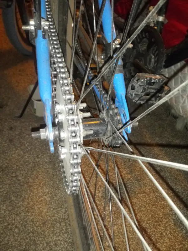

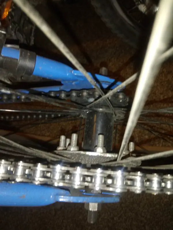

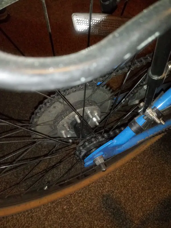

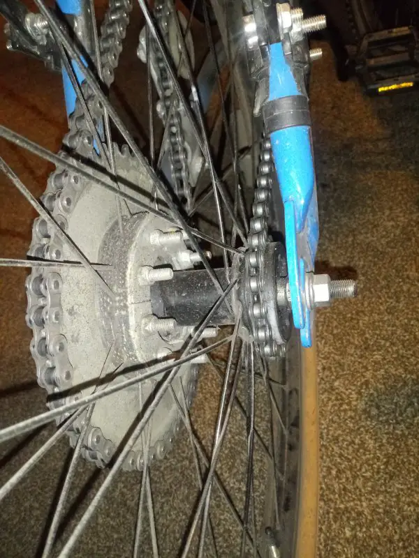

Can you post some pictures of your hub? That will help us give some advice.
