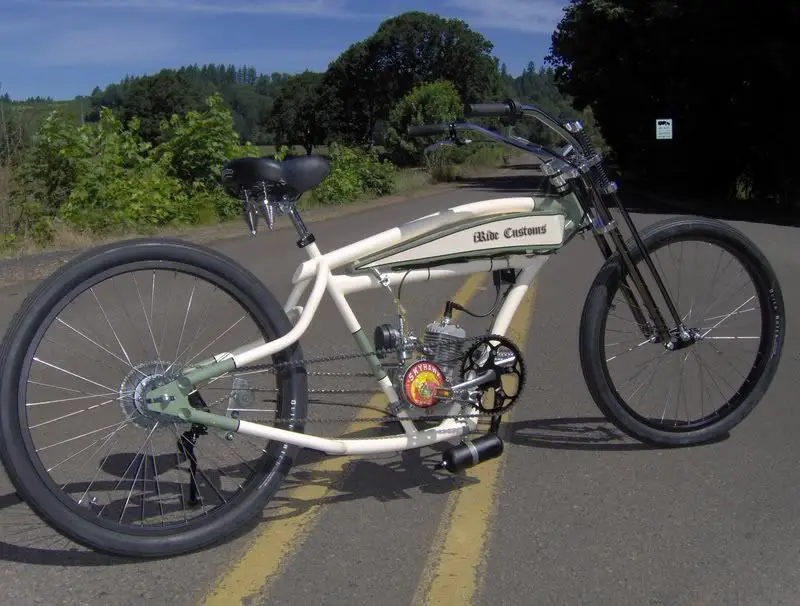

Try painting some other parts of the bike with a different color. I painted Brutus with rattle can paints from Home Depot.......
Truth is I expect more people will do the home depot paint than custom painting so this is probably good information for the rest of us. Love your gas tank.. is that a bladder inside the bike?
