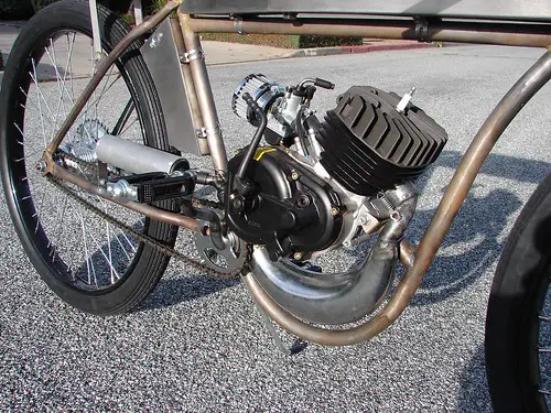

Yes, it is a drum brake rear. I figured with 9.4 hp brakes would be important! Cool thing is I have been able to maintain engine and frame centerlines. This Morini is not offset to the right. The crank was a challange and I tried all the available options, none of which have the standard one piece crank sprocket mounting. So when you can't find what you need you make it. My bro has been helping a huge amount on this project. When it came to the crank assembly I held the torch and he handled the leverage with a big piece of pipe. Problem solved! Front bicycle side is a 28t Worksman sprocket.

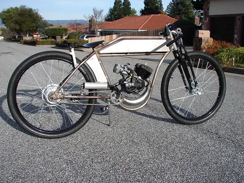

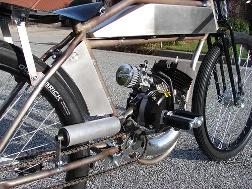

Couple shots from the shop. This is the new Sportsman Flyer Racer Edition. A stretch and loop Flyer frame using a widened Worksman rear triangle. 9.4 hp Morini engine with custom mounts. Front and rear drum brakes on steel Worksman rims. One of my stainless laser cut tanks designed for this frame model. This thing is going to haul ass!

Congratulations...A true representation of our art and Hobby. Its really beautiful. You should be proud of it.
I really like the under and over exhaust routing.
Just one tiny glitch that I see is that serious kink in the exhaust spigot location, that will seriously hamper exhaust flow and performance.
I would humbly like to offer an altenative.
Using a few readily obtainable Stainless steel bends I would make the spigot longer and angled to the left side of the frames down tube, then wrap the head tube around the down tube and then into the tuned expansion chamber-
(many old school loop frame single cylinder racers of the early 1900s used this arrangement)
That severe a bend is really going to hamper top end flow.(I bet that kink glows Chery red at night!)
Some times you just have to take the long way around to get were you want to go faster!
Please understand Im not knit picking in any way its still gorgeous...
Love the silencer placement on the righ/drive side.
No top rear motor mount?
Id polish everything and clear coat it all Raw Metal, maybe a few old timey racing numbers and decals?
Some Leather for the saddle?
Its gonna be a real monster either way.
Very nice build.
BBB
BBB,
The first bend is not as tight as it may appear. If you take it off and look inside it actually has a nicely radiused flow path. Typically I only build these bikes to a fairly complete kit, but this one I will finish out. It will be getting an Indian Red paint job, leather wrap grips, gas tank and oil tank logos, and the seat will be padded and leather covered. I will update the forum with more pictures as the build progresses.
