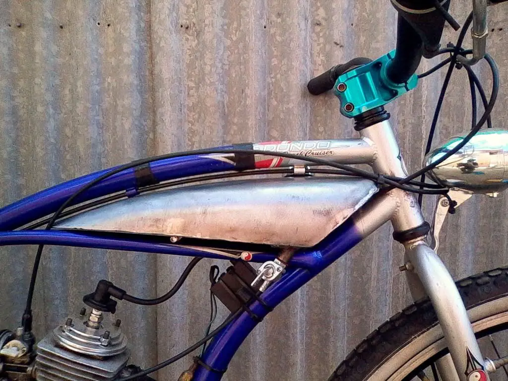

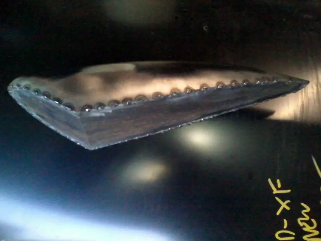

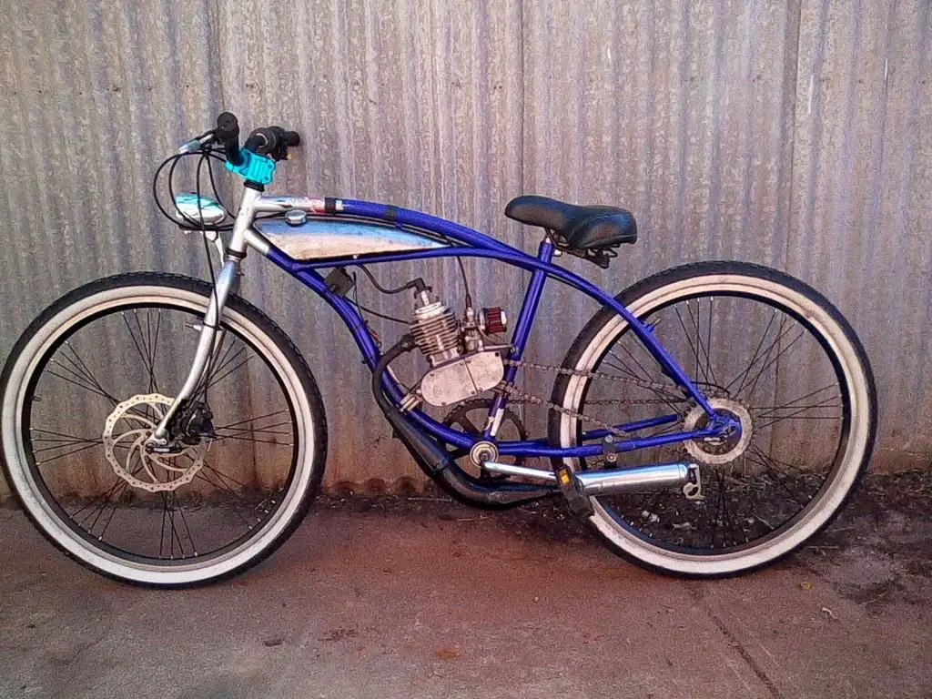

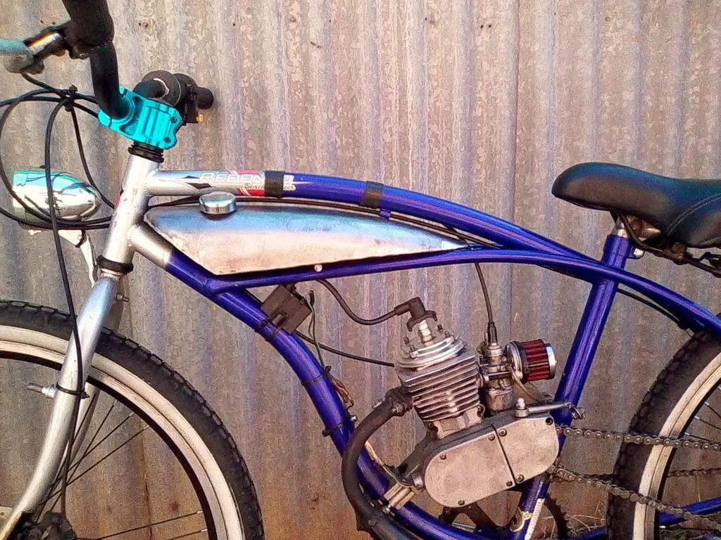

today i fitted my 36t rear sprocket now the chain is the perfect size to run with no tensioner and i still have plenty of adjustment once the chain stretches. after trying a few different fuel tank ideas i decided to cut the wcc tank i have and try make it fit so far its turning out prety good
i made the bottom of the tank from a 1.5mm steel plate and tacked it on, im going to use a harley push in oil tank cap for the fuel cap
