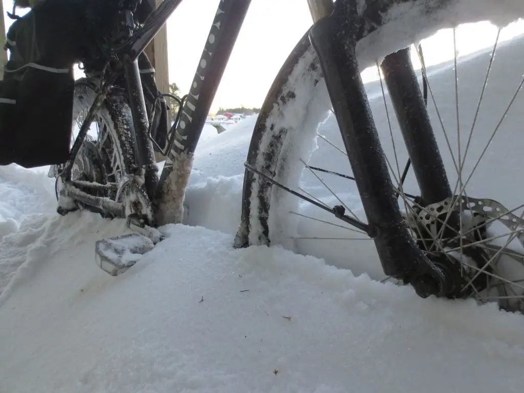

Mongo, my daily rider beater/commuter pretty much fits that description w/a whopping 1.3hp electric... but it's not only speed, it's mileage & thus maintenance & wear which equates to reliability that's a concern. Motorized, it's likely you'll not only ride faster, but far farther then you'd normally pedal - in the almost three years and well over 6000 miles I've beaten Mongo I've adjusted my brakes three times (once each spring, regardless of need) and replaced the pads once, just the rears & that was my fault, I'd spilled chain lube all over them like a dolt & didn't trust them anymore;
The same conditions & riding style with just a bit more distance & speed (two stroke) resulted in this with rim brakes;
Will that happen to you? Not if you ride in "average" conditions for "normal" distances and are attentive to your maintenance, repairing/replacing what needs be when it needs it - including the rim when it's worn. Are rim brakes "good enough" under those circumstances? Sure, provided they're not wet or packed with ice they stop great...
...but isn't reduced maintenance/increased reliability a good thing? Is "good enough" good enough when it comes to braking?
Rim brakes do stop a bike well, they're common and not particularly difficult to maintain and if that's what the bike has already, if it's not a priority to upgrade anything - there's nothing wrong enough with them to consider anything else... but it's been proposed that they're somehow "better" then discs, that's the thing I just can't agree with is all ;)
