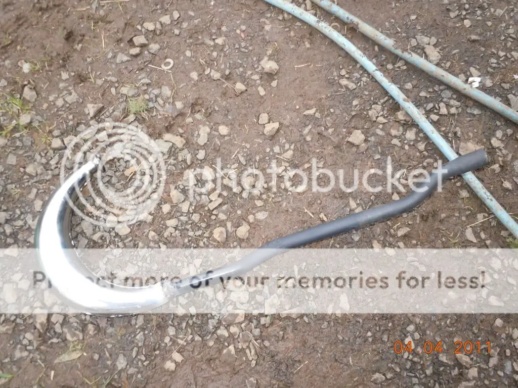

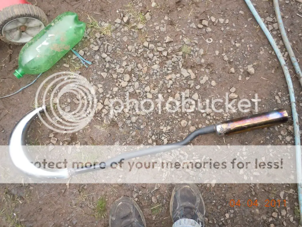

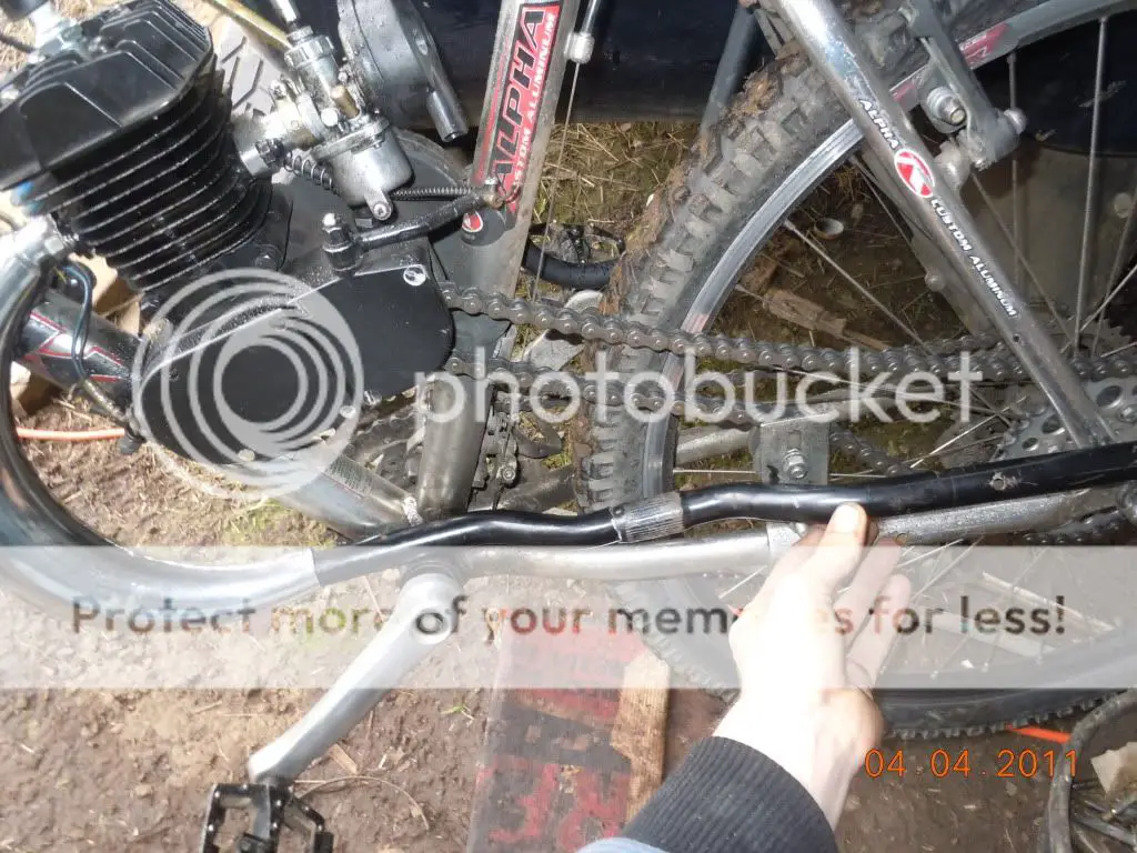

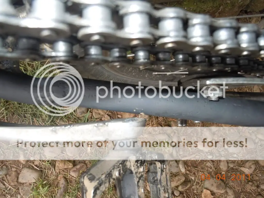

so yesterday i got this idea to make some costom exhaust out of my expansion chamber and my muffler. but i didnt know how, and needed some matierials. so i grabbed an old pair of handle bars layin around and decided it would work. so i started away. a regular pair of handle bars doesnt fit right. so i had to cutt the bars. then rearange them to fit the bike right and clear the pedals.
started with this exhaust
then decided how i would make it.

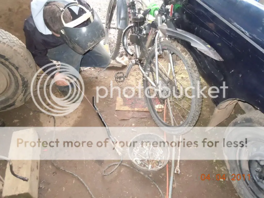

then did some welding

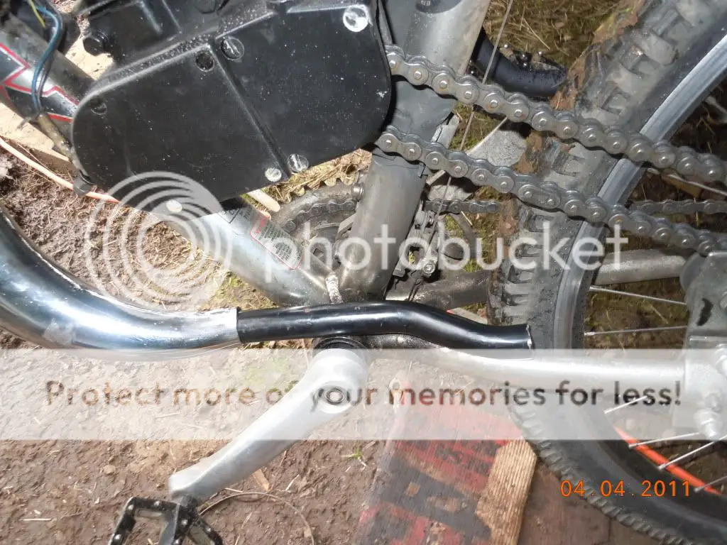

welded the black pipe to the silver chamber

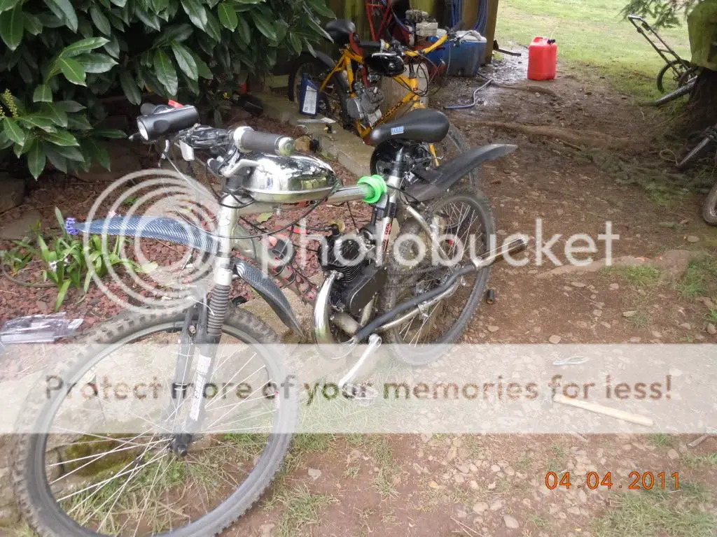

my finished product. a expansion chamber with a cool lookin exhaust dance1
all out of a simple pair of handle bars, tell me what you guys think

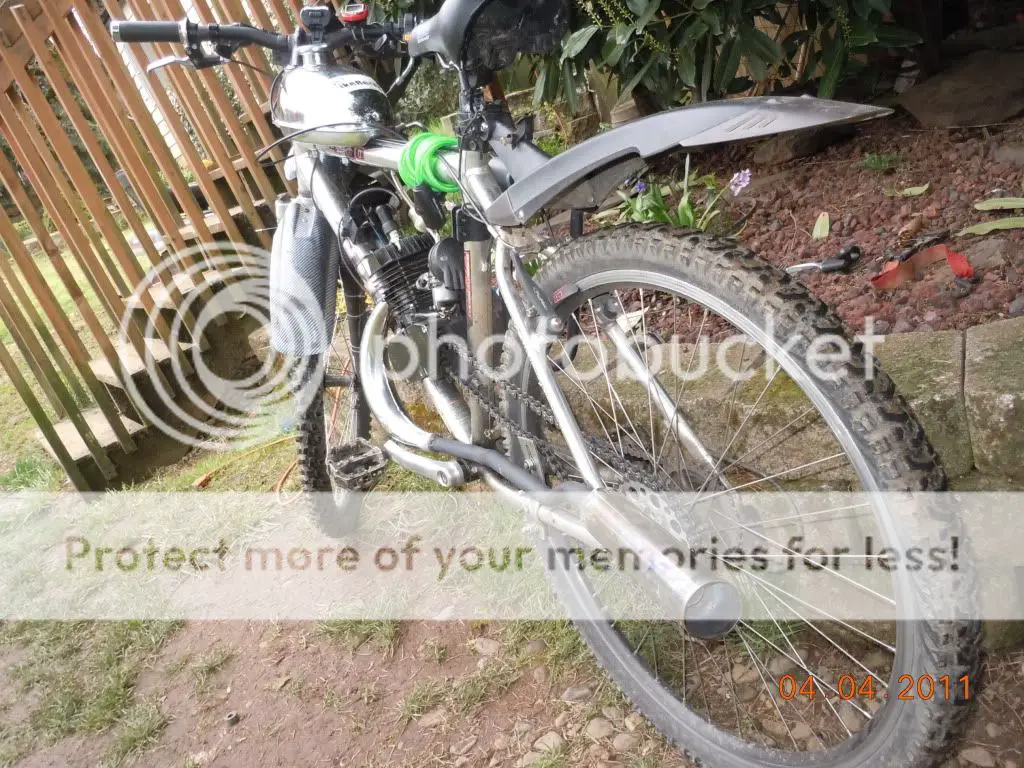

so i took it for a ride. i put in a new kind of gas. ill get you guys a link for it. and it pulled 40 mph pretty easily. the pipe made the motor stay warmer a little better. and i got a better power band out of it once i hit 30 mph, it just took off from there. that and a great deep sound =). recommended build for sure.

well iv been runnin this pipe now for a few days. deff an improvement. my motor can hold hills better, lots more power. stays warmer. runs better. lots better sound. and looks sweet. = ) oh and the gas is making a difference. solid running. not choking out any at all.
