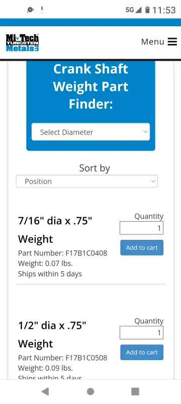

You can never completely balance a single cylinder... To have a completely balanced engine would have to have opposing cylinders like a motoguzi... Another way to Ballance a crank is to add weight to it... Its expensive but won't increase the case volume... One could tap and plug the existing holes with magnesium/aluminum and Ballance with tungsten... Useing a digital scale
