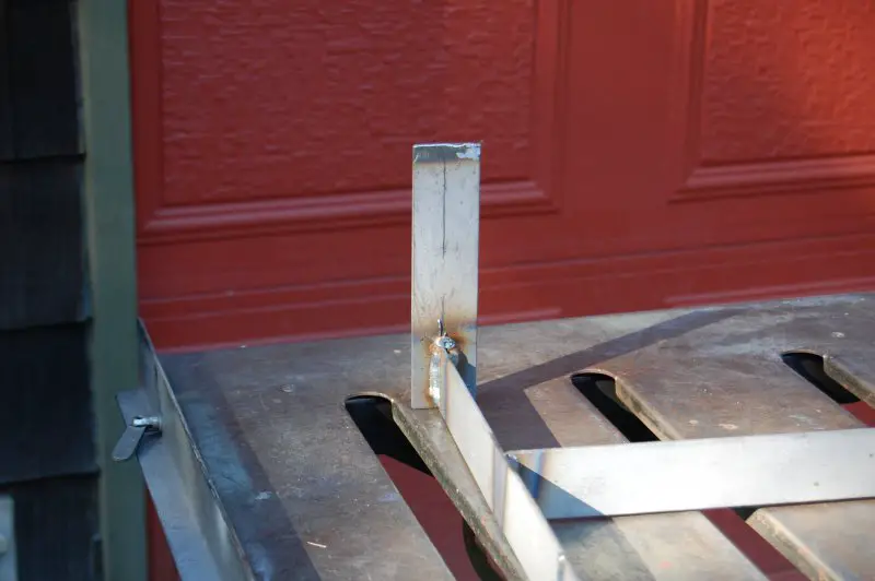

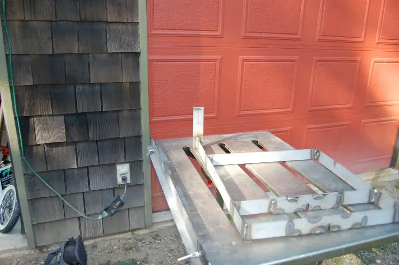

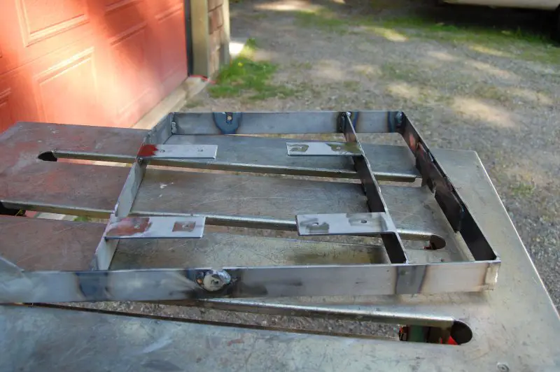

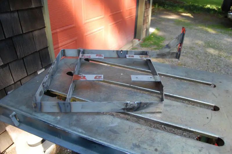

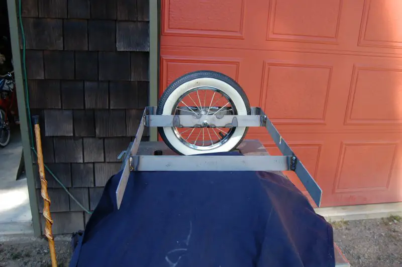

I have the majority of the sidecar frame welded up. The upright tab will be drilled to attach to the rear wheel hub bolt and then a brace will be added. I'm not sure just how else the frame will be attached to the bike just yet.
Steve.

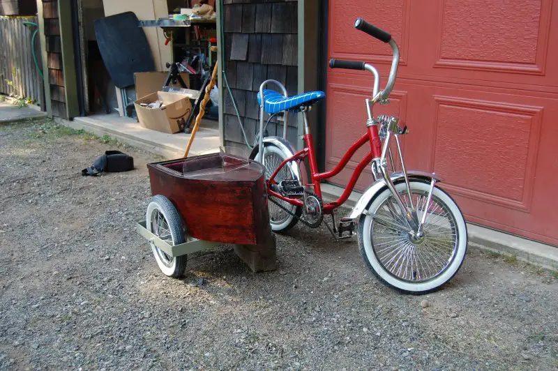

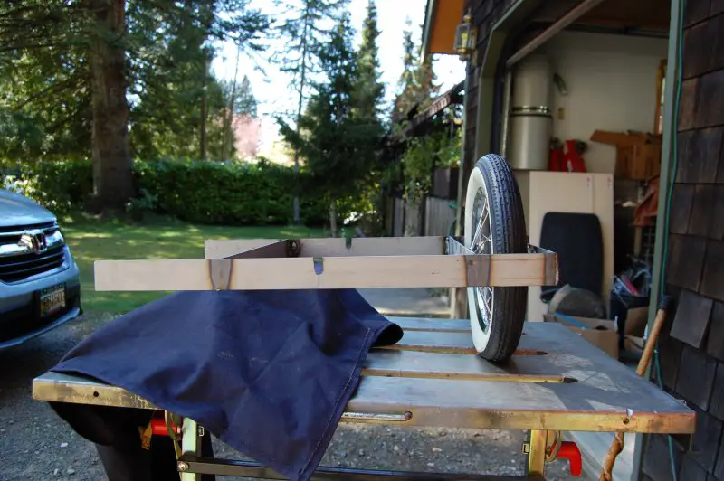

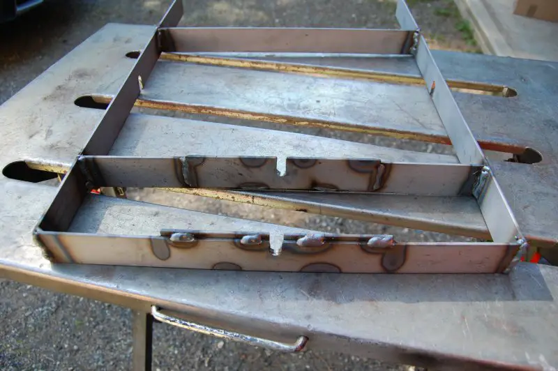

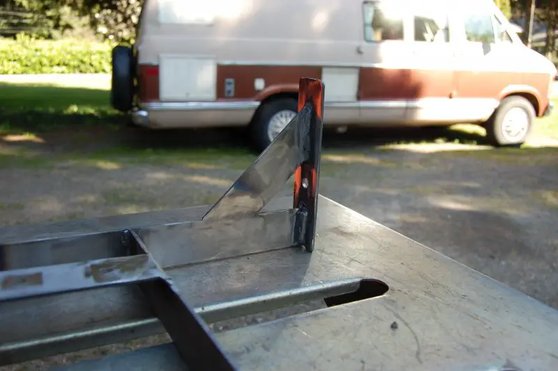

Added a brace to the back wheel mount and added mounting tabs for the sidecar body. Cut one corner off and angled it so it doesn't hurt her foot or leg while she's riding.
Tomorrow I'll have to bend some tubing to make a bike to sidecar frame mount.

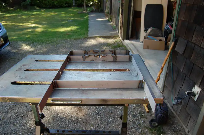

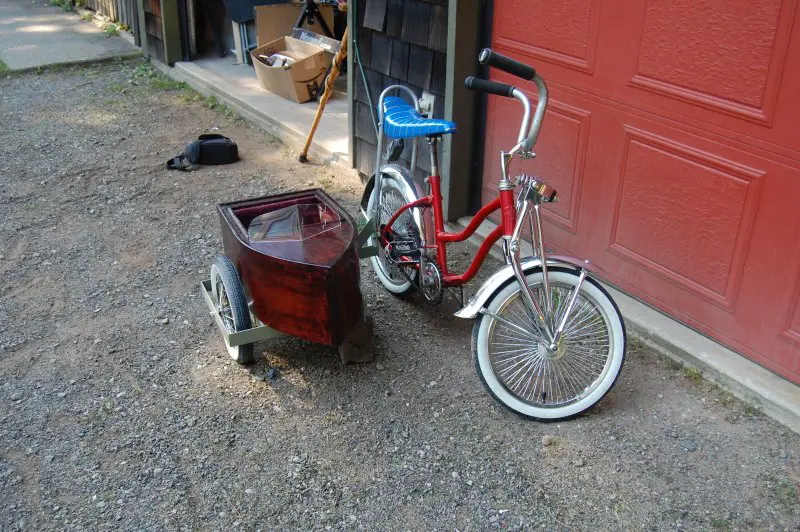

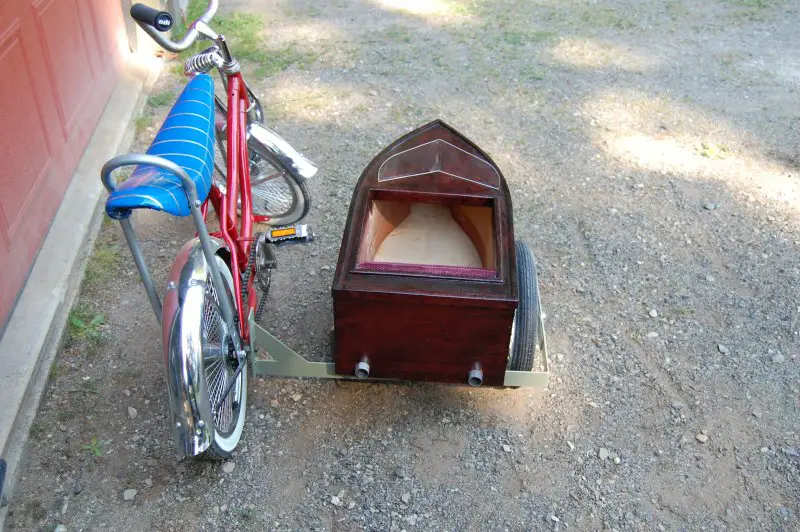

Frame for the sidecar is ready and now it needs the welded areas sandblasted and a small amount of body fill applied to smooth a couple of areas out. The strut from the side car to the bike is ready as well.
I ordered some chrome 3 piece clamps used to attach exhaust and foot pegs to motorcycles. They are available from 7/8" and up. I'll use one of them to attach the sidecar brace to the bike. I've include the link to where I purchased them.
Steve.

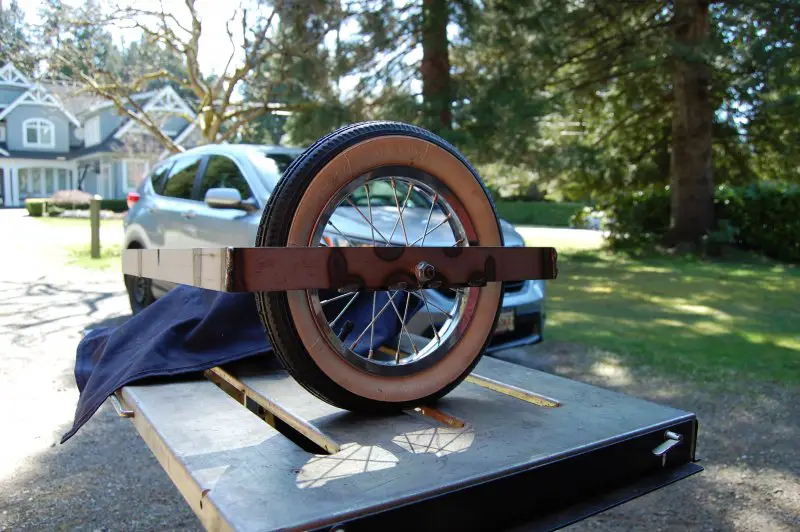

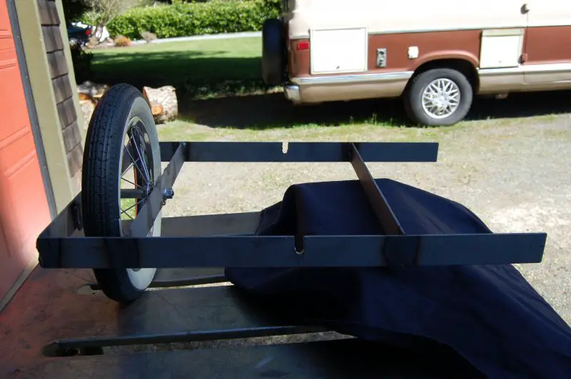

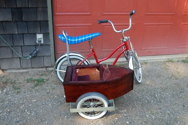

The frame for the sidecar is in primer and ready for paint. The support arm is just about done and will run from the bike frame to the side car. Still some filing and sanding from where I had to weld two pieces of tubing together.
Her dad is OK with an electric mini bike if this doesn't work out and I'm thinking I'll build one anyway just to do it later in the spring.
