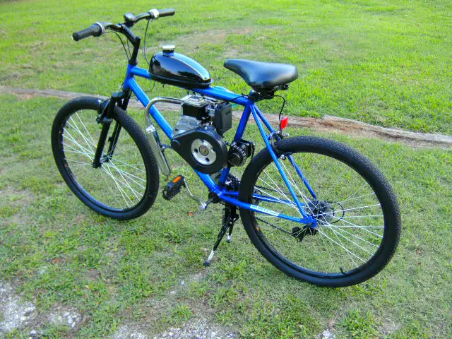

ITS FIXED! Just got back from a 10 miler over one of my favorite runs. Not a single skip, or should I say overun? Even got pretty agressive with the shiftin, still behaved. Just glad it finally got figured out! Thanks again everybody! couple of picks of the varmint.
