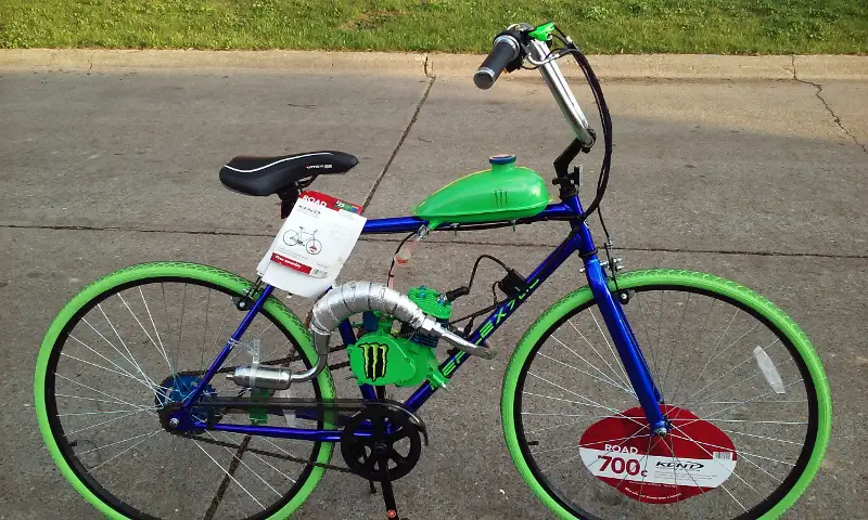

Hey everyone been away from the forums for about 4 years now. Recently decided to motorize a fixie. Everything went well but after 5 minutes into the first ride my master link flew off and the chain came off. It was my fault i put the C clip on the wrong direction lol. Let me know what you think dance1

Can you adjust your drive-chain length to get rid of that tensioner? One less thing to fail...
Good looking build, nice and clean.

Thanks :) I'll sort out the chain and filter soon.

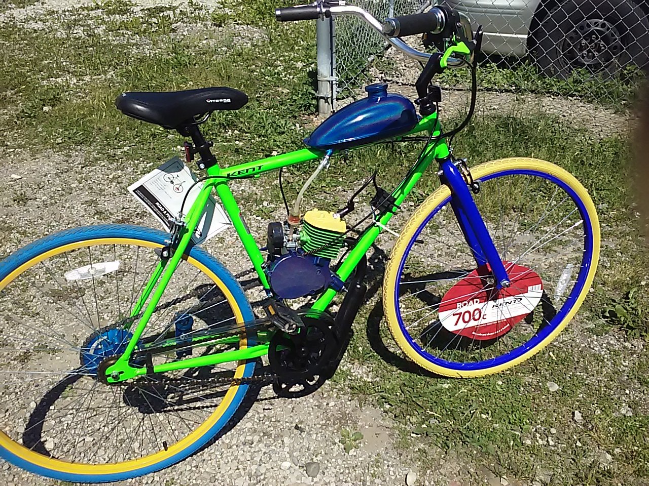

Paint looks very nice and the colours remind me of the old Hot Wheels when I was a kid in the , the, the, well, it was a long time ago.

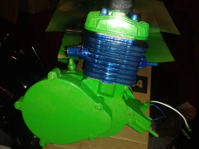

bought it from boygoesfast on e-bay i always pedal mine without the plug around the block so that the chain seats and the piston has a chance to score the cylinder a little without all that oil and i oil the bearings with 2 stroke oil when im assembling them

I don't personally think scoring the cylinder is a good thing to do. Even microscopic nicks can lead to loss of compression and the rings can even catch I'm those microscopic nicks and make the scratch worse, leading to a higher loss in compression and even seizing the engine. After all, those cylinders are only lined with cheap chrome. Just my opinion.
i didnt really mean to say score i meant to seat the rings i was also thinking about a question i was going to answer on another web site LOL i was answering a question on reasons to replace the cylinder and i just thought about that while i was typing this post i do way too many things at one time LOL. i do two builds at a time and do other info on a few groups so a lot going through the ol" mind at once i just finished painting a kit and fixing another build from craigslist i could make a killing just on craigslist buys LOL
My personal philosophy is, whether it's two stroke or 4, never spin a gas engine without oil in it. To me, it's just asking for problems.
like i said i soak every thing with the 2 cycle oil and dont go more than a few feet just around the court yard
