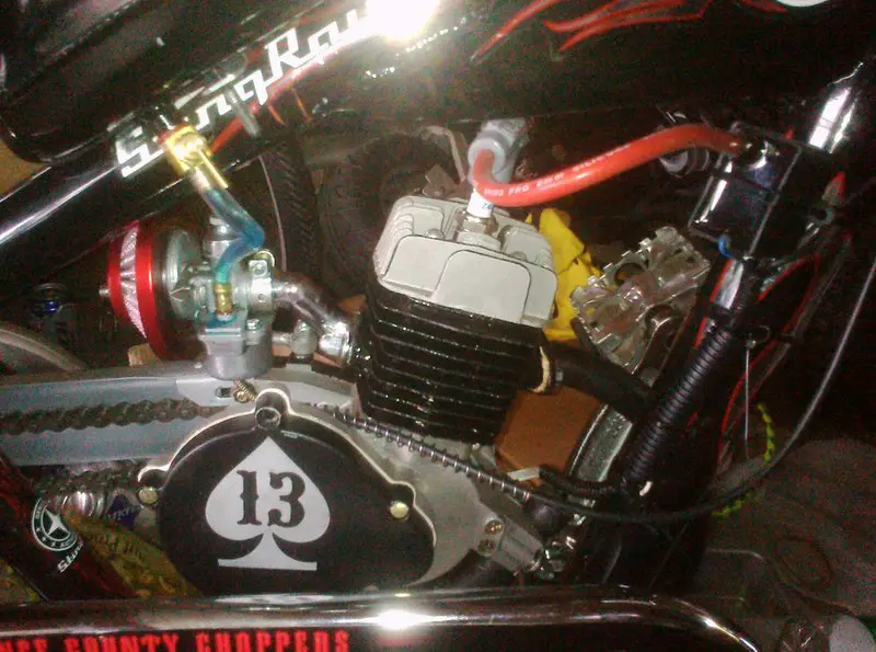

good luck at getting 40 mph out of it.but be careful ive put mine down twice on tight turns at about 15mph not much tread on the sides of the tires.also peds hit ground on tight turns. mines running a grubee starfire gt 2 ho,larger tank,cant fill, will leak due to steep angle. upgraded msd plug wire,ngk plug,high flow exhaust and hp air filter,pirate cycles 36t and hub adapter,was running a bigger jet in carb but went back to stock.might be getting 25-30mph out of it. remember its a bicycle that looks like a motorcycle not made to go 40,stock breaks are weak at best.just dont want to read about you getting hurt. peace
