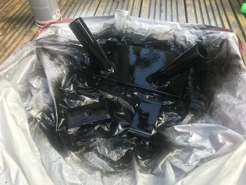

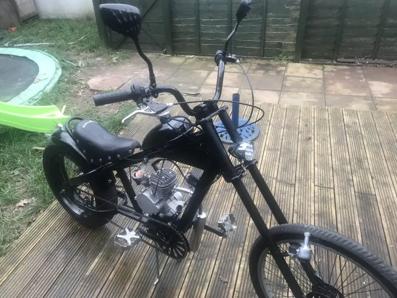

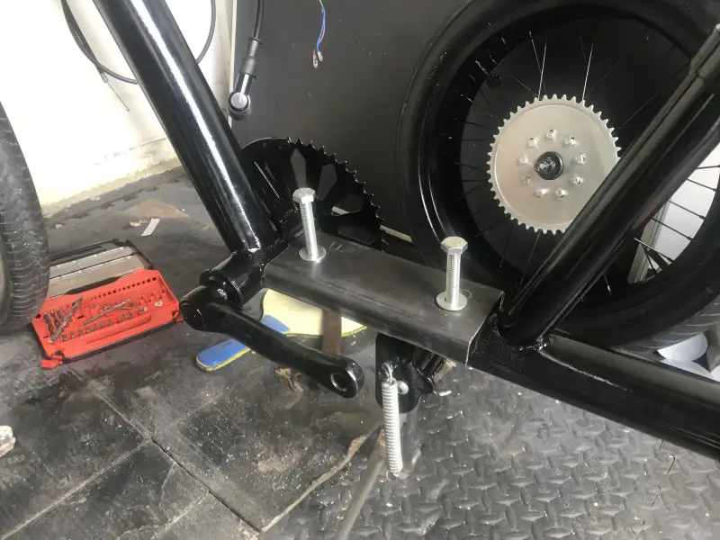

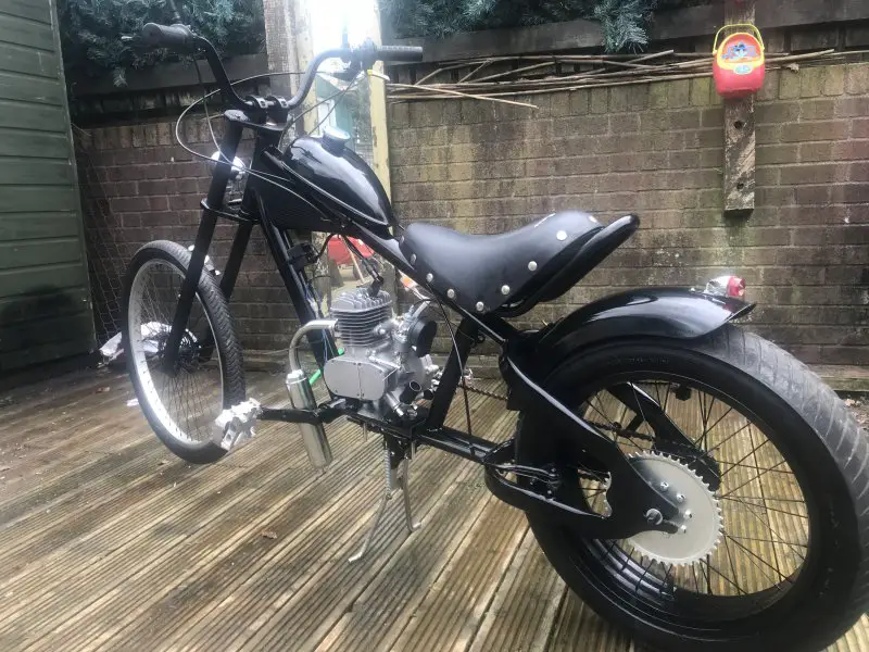

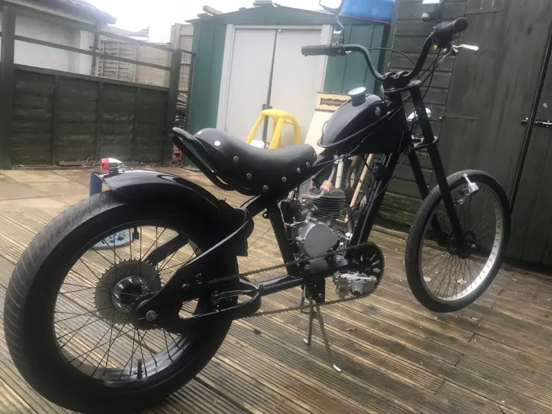

I built mine in a few days including spraying it, I made my own engine mount, used old Barry’s design but only took a couple of hours + £7.00 of steel but fitted perfect.. just need to get a chain long enough now as the one in the kit was too short ..
