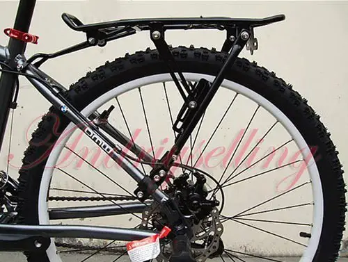

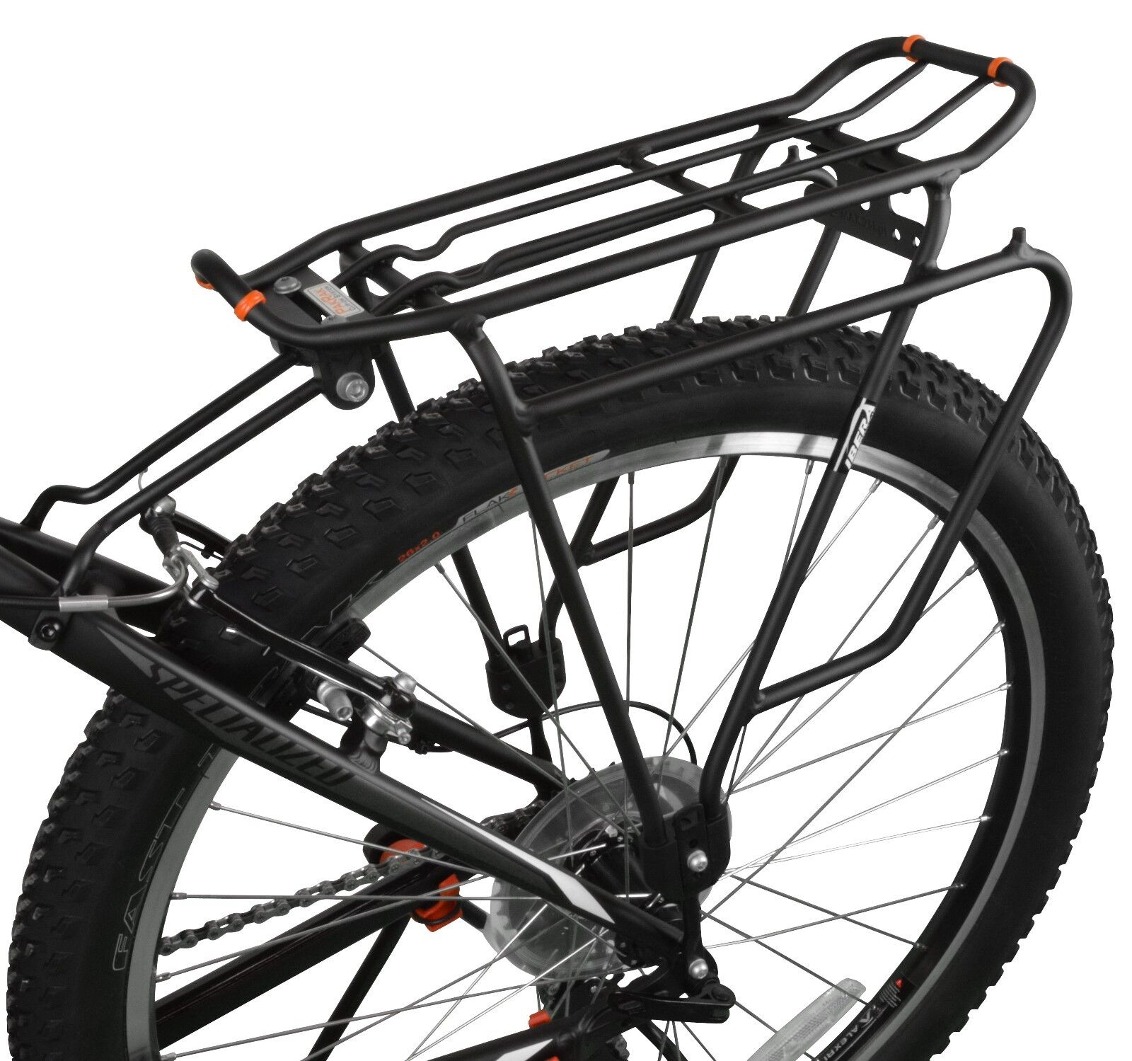

On the rack subject.... If you dont plan to put very heavy loads on the rack like maybe 20lbs or less, I'm sure the stock rack will do a good job, but if you plan to haul some heavier loads from time to time you might just scrap the stock rack and go for something like this which will take a much heavier load.
http://www.ebay.com/itm/MTB-Mountai...579?pt=LH_DefaultDomain_0&hash=item5408fc1b03
