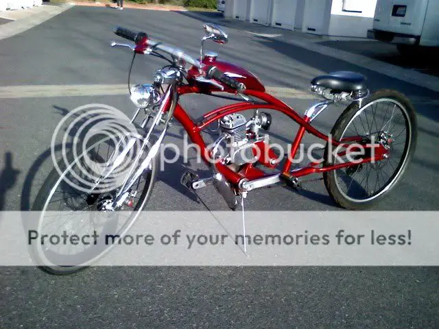

Hello from San Diego and a hearty thanks to all who have shared ideas and pictures here. I have built a number of custom motorcycles in the past, with one of them receiving a feature page in Iron Horse magazine. This is my first motorized bike build and you have all been a great inspiration.
In tribute, I have posted a picture of the finished build. And for those who might be having problems with chain rub on their stretch cruiser frame and clearance over the pedal chain guard, I have also attached a pic of the chain pully assembly.
Yes, stretched the tank. Used insulating foam, shaved it down to get the shape, then fiberglassed over the foam. Probably should have taken some pictures of the process.

Maxvision, this forum never ceases to amaze me with the amount of talent it's members present, they're designs & modifications show a never ending supply of good ole American ingenuity, & you my friend have demonstrated your talents with this absolutely awe inspiring stretch cruiser build, you are an Artist & Inspiration in the stretch cruiser style builds.

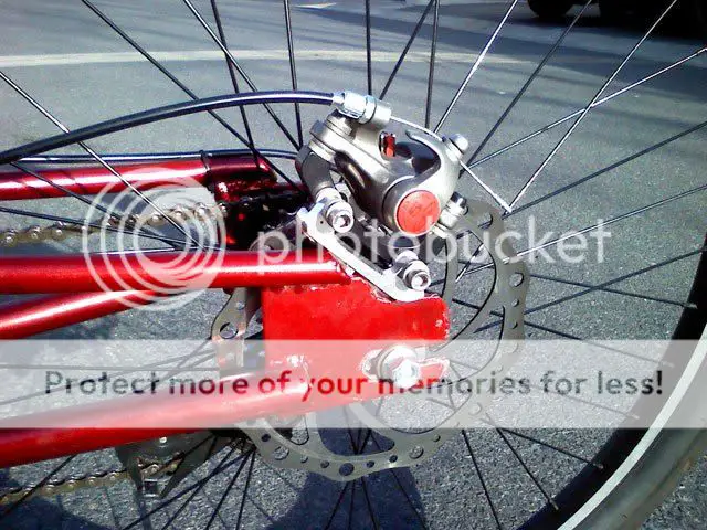

Your post on upgrading your stretch cruiser to disc brakes, just shows your ingenuity & talent I'm amazed this build keeps evolving for the better!
"Quote Maxvision: What a difference the disc brakes make. Hardly have to pull at all on my dual brake lever and stopping is FAST and easy. The bike HAULS A$$ with the shift kit and am always on the lookout for the po-po. Used to call my bike the "Death Cycle" cause it was so hard to stop, now I just call it my "Red Rider". End Quote"

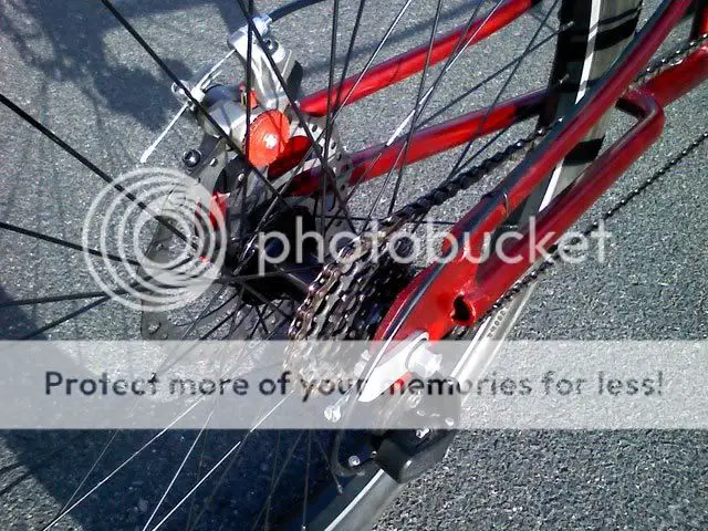

OK Crazy Horse, here's the best pics I can get for you on the shift kit. I built my rear motor mount and welded it to the frame. Instead of holes to bolt the engine on, I made slots so I can adjust the engine up or down to tension the shift kit chain. You can't see the slots because the chain adjusting bracket covers them up. Then I just attached the threaded rod for shift kit chain adjusting to my rear motor mount.

Thanks Maxvision, for sharing your idea! Stretch Cruiser ( Sick Bike Parts Shift Kit ) modification for use on Stretch Cruiser builds.

Maxvision, a fellow member was asking about adding a rear disc brake to his Stretch Cruiser so I thought I'd bump your thread so the member could see this thread!
