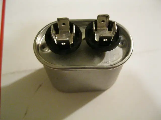

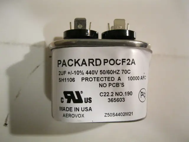

Thanks Rohmell I didn't know that stuff about the industrial ratings. I got all my components except the caps. Theres another place in town I called today that has one cap at the warehouse it's a 2.0 uf 440v he said I'm going to pick it up tomm. I'm gonna try and take some more important photos tonight If the batteries hold up to get them taken and I am eager to post them. Especially a photo of a flyback board that I want you to see and tell me what it could maybe be.

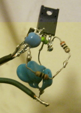

heres my first unsuccessful attempt @ a working CDI. I think that I might have cooked the SCR on removal from the old board. I havent given up yet still getting components together.
heres my components is this cap ok to use?

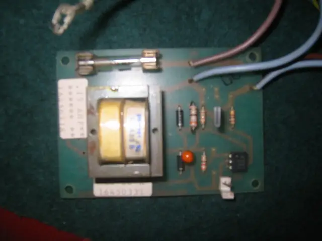

I found these interesting circuits. any Ideas as to if they can be used or modified some to work? or just what they are
I have much more spare stuff but those above looked very interesting.

Any ideas as to what the flyback circuit i posted could be I can take more.
