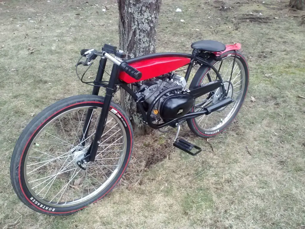

Hi Kieth. I actually have several roadmaster bikes. You will need a custom mount for any engine you decide to install. My last build was with a predator 79cc . The bike can get up to 40 with a 200 lb rider. You can just get a bolt on jackshaft from Agk.
As for the Gc 160 . It is too talk for the frame. The 212 will fit but I would hold off until you have some more experience.
Also the roadmaster forks look the best in my opinion but, they are very unstable in corners.

SlowBalt- is that a kit tank covering your clutch and jackshaft? Brilliant and looks good! Also, I thought the Roadmaster springer fork was the "best engineered" springer fork design??? Think I read that on the CABE. The Roadmaster springer design does seem like it would alter the trail value as the springs compress, but so does the Schwinn design.

The fork floats like an old Caddy .Any bump or throttle into a corner will change steering angle mid corner. they are fine on a pedal bike, but scary on a motor bike.
I'm using them on one of my two stroke bikes, but I know what not to do.

Thanks for the input! I love the look of your bike. I'm planning on stripping the frame/fork down and painting it black like yours. It's red and white now and it pretty rough condition paint wise.
Did you fab your own in frame tank? You're not willing to part with one of them for my build are you?
