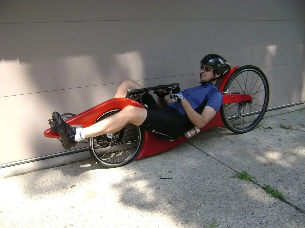

Here is the type of body work you can build for a delta trike. The trike in the pic costs over $10,000 with the body shell. (Gag)
