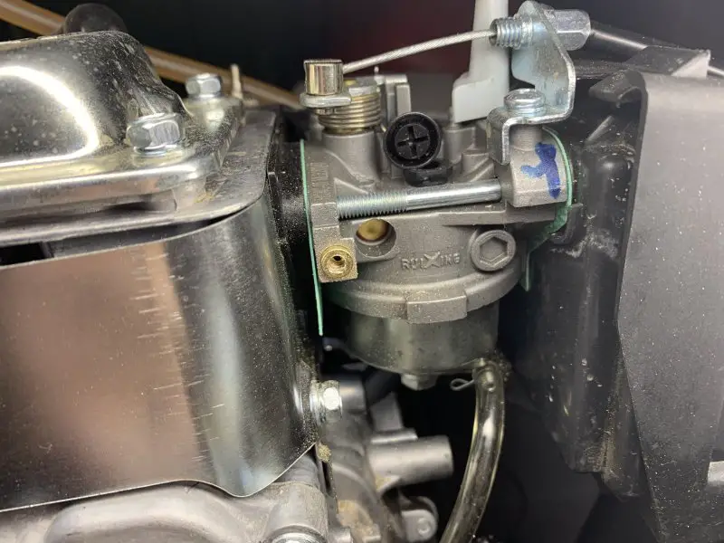

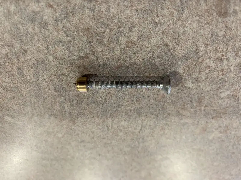

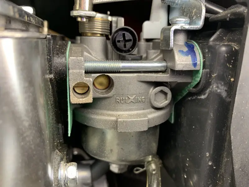

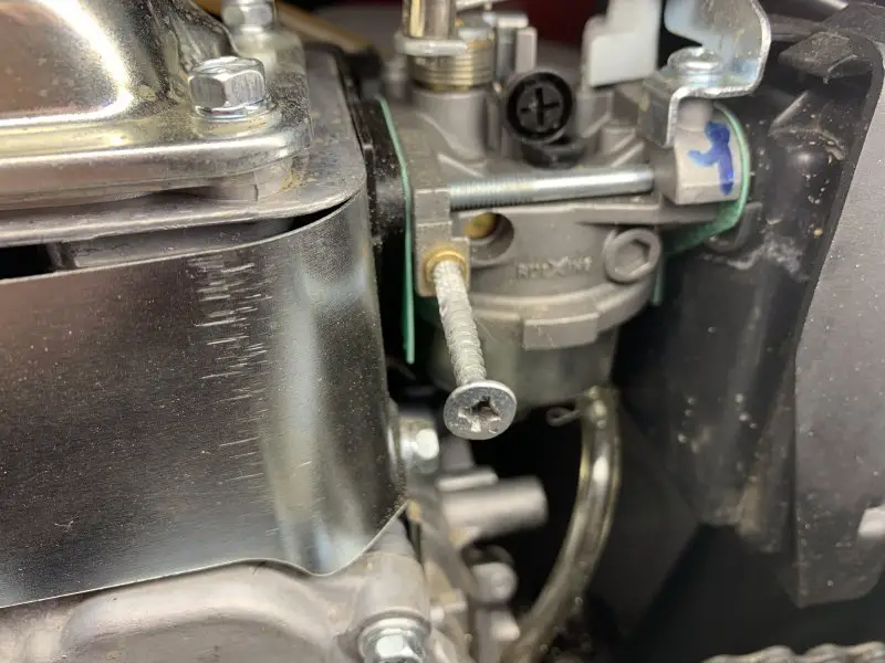

I though i would just post these pics to help, although i still don't know why I would make the bike run a little richer... The motor is running fine before removal, higher rev?

That "was" an idle circuit screw. It did have a driver slot to adjust it. The counterbore just to the right is the plug you wanted.

He removed the correct plug.
The plug covered the air mixture screw.
Do not remove the plug in the counterbore just to the right.
