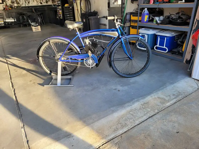

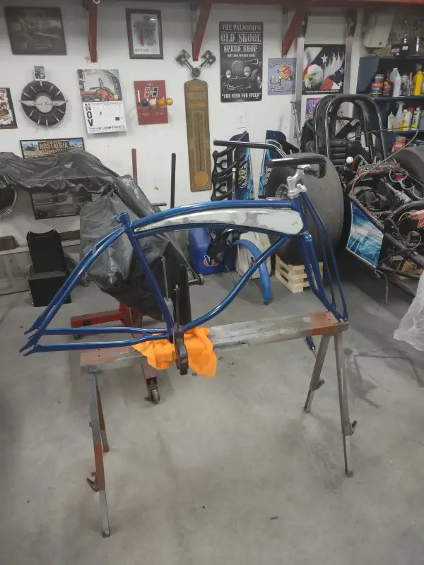

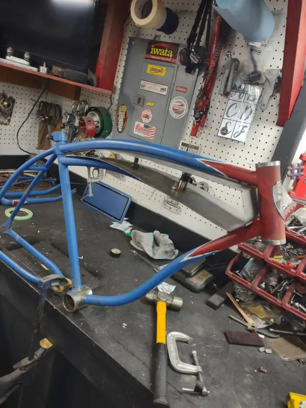

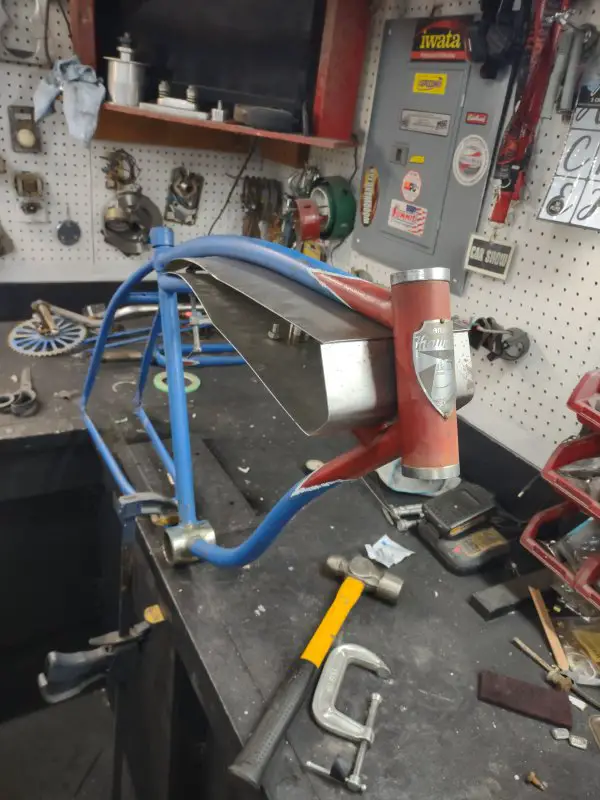

Bought this old Gambles Hiawatha on an online auction and was able to use everything except the wheels and seat. I made the tank and hammered the fenders out the best I could stripped it down and painted it. Was a very fun project

Welcome to the forum, Merry Christmas too. Nice bike! Keep a close eye on the fenders, engine vibration will cause them to crack or the mounts to break. Several members have had them fail.
Bikes looking good. I wouldn't worry too much about the fenders on your bike
You got a good old fashion USA bike with 2 Good fender U support braces
People who have had fenders fail are owners of Chinese bikes. Their fenders only have one U brace. When there mounting L bracket breaks the fender wraps around the front tire and makes them crash.
This don"t happen with USA bikes with 2 U braces on their fenders
For a fender like this to cause an accident
The L bracket would have to break and one U brace would have to fail for the fender to cause an accident
