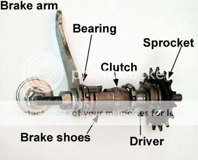

Fulltimer, doe's this look anything like your axle. Less the brake shoe's of course!
Peace Crazy Horse. brnot
That seems pretty close to what I have. But, I'm doing away with the coaster brakes. That is causing me a lot of grief!
