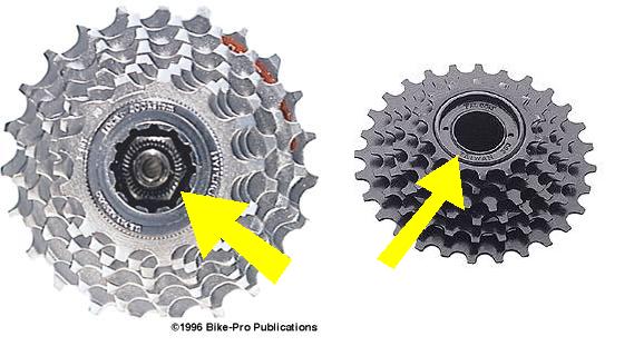

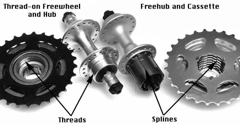

First you need to determine what kind of hub you have a freewheel or a cassette; they aren't the same thing.
Then you either need to replace the screw on freewheel or replace the cassette hub. Freewheel axles are prone to bending. This may be the reason your wheel has a wobble. You can get a cro-molly axle which are harder to bend. I personally recommend getting a double walled rim and a cassette hub.
