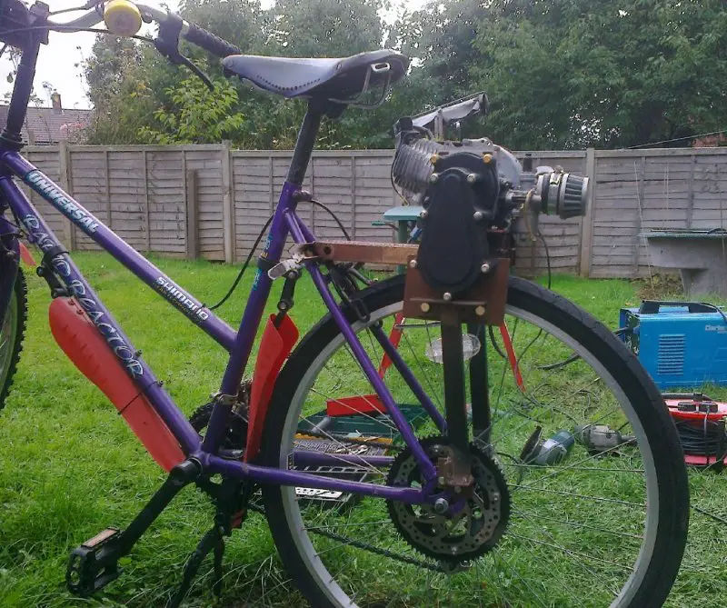

I realise you must face the twin horrors of spending money and buying something modern, but what about doing what I did on my still in progress cyclemotor? Use a 6 bolt disc brake hub and mount the sprocket on that? I used a brake rotor as the intermediary between the 6 bolt hub and the 4 bolt sprocket.
Ats a great idea mate ill look into it thanks
