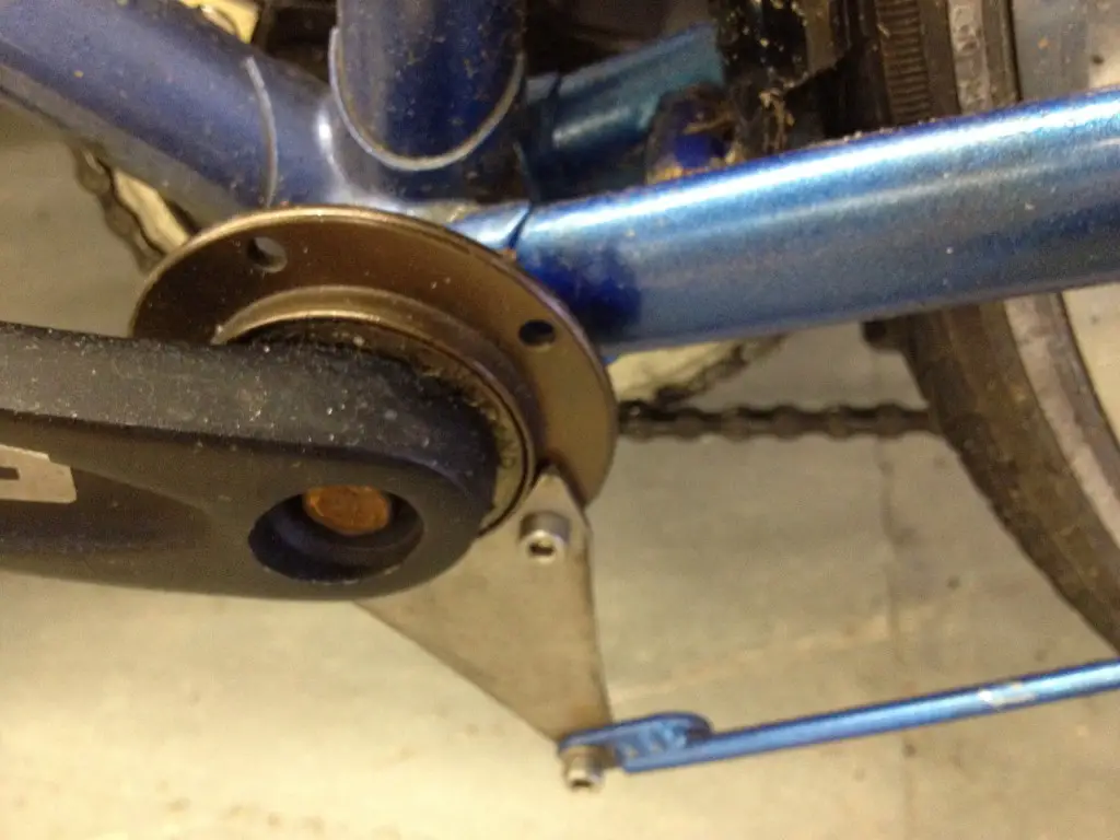

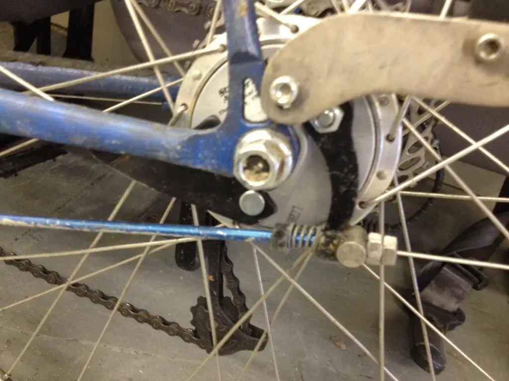

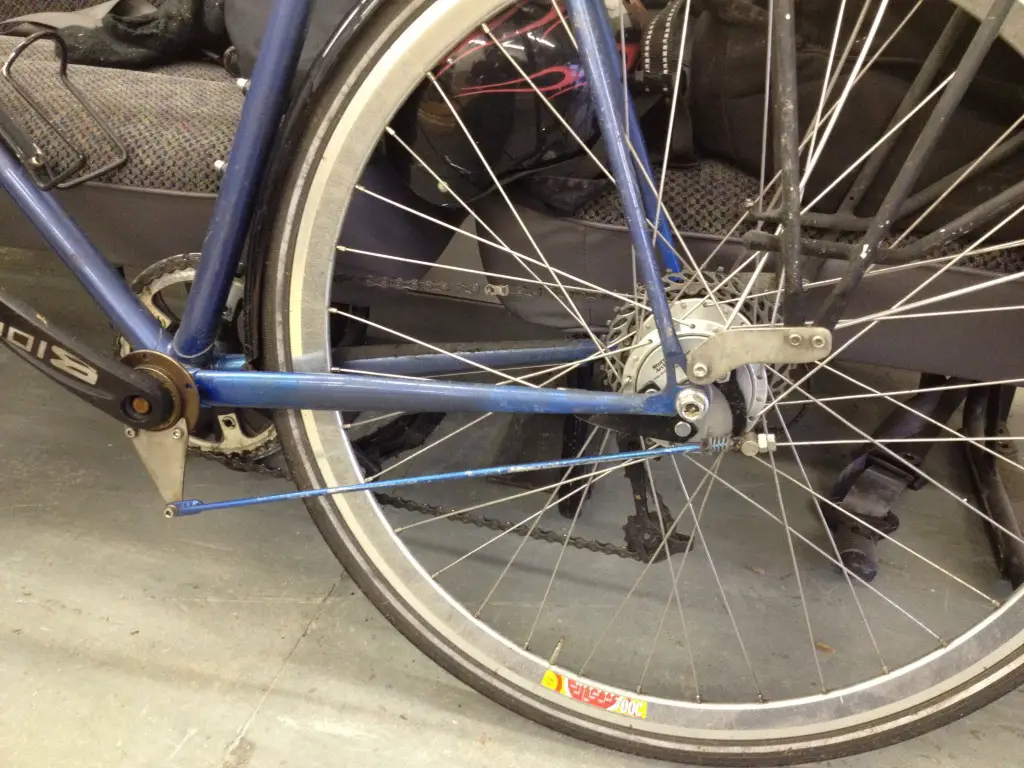

I found this interesting concept. Builder used a flanged freewheel on the left side to operate a lever that controls drum brake by back pedaling, similar to using a coaster brake.

that's pretty cool. i've been wanting to make a drum brake with a rod linkage set up for a while now, but never thought of that method.
i was gonna do something like a motorcycle with a brake pedal you could hit with your heel.
Maybe if that can be done, I can make a foot brake to work on my pedal-less motorized build. Although it has V-brakes, a cable to a foot pad that pulls a cable?
But if that is done, then since I don't have a manual clutch hand lever, the centrifugal automatic clutch the reason, I could put the front brake lever on the left handle bar and only have a twist grip throttle on the right handle bar.
