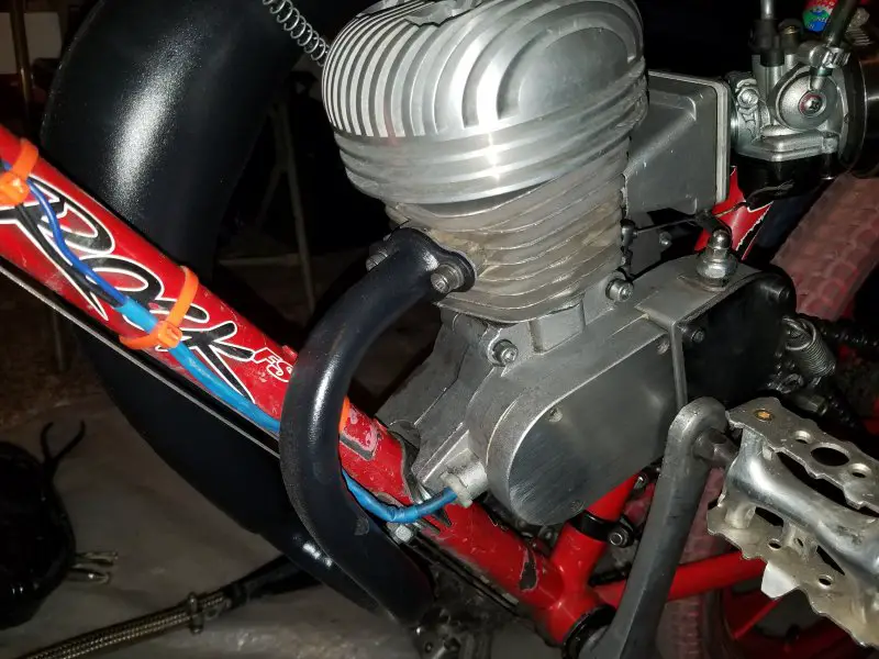

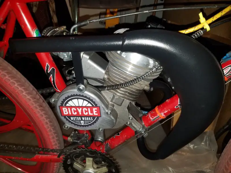

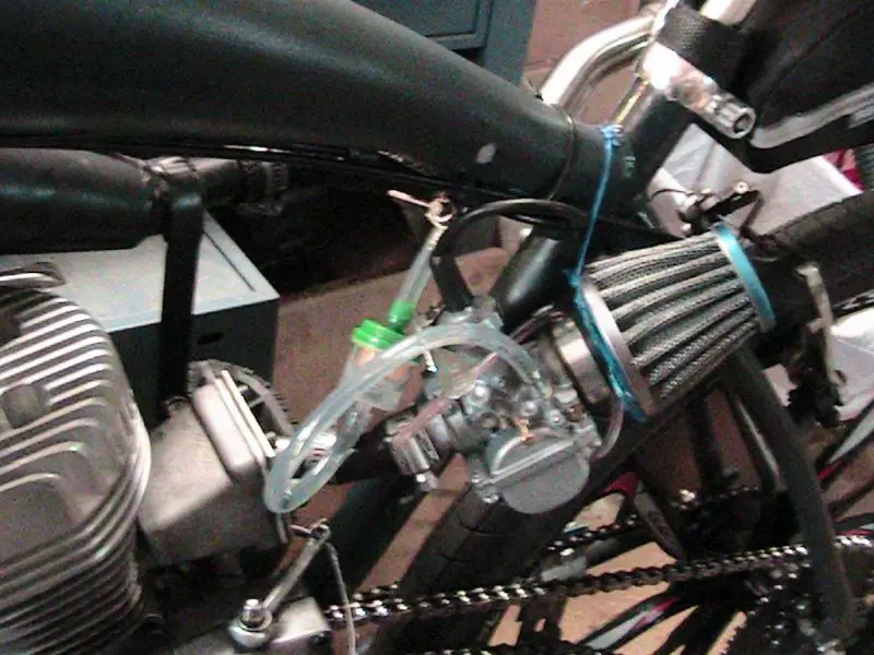

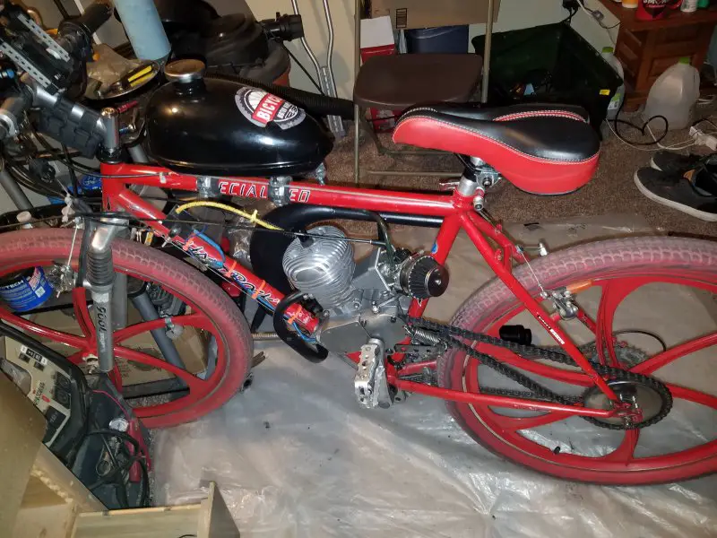

Hello family and friends! I have been trying to obtain 50mph on my pk80 and am getting closer with every mod. Right now I'm hitting 41mph(gps) and know it will go faster.
  • Pk80
  • High compression head
  • Copper head gasket
  • Ported/matched intake/exhaust
  • Ported/matched knifed transfers
  • SKS bearings crank/clutch
  • G2 Reed w/19mm intake
  • Dellorto SHA/HP 15.15 with .68 jet
  • Windowed/ramped piston
  • Fatbelly expansion chamber (cheesy but cheap, temporary till mz Miami restocks the mz65 pipes)
  • 36 Tooth Sprocket
  • NGK B6HS Plug
  • Stock CDI
  • Stock timing
  • Stock magneto
  • .6 gallon tank
  • 20:1 fuel
  • Spring chain tensioner with sprocket roller
  • Custom tank mounts
Right now I have a wicked power band that takes me up some pretty good hills. 20-30mph is super quick. 30-40mph pretty quick too. At 40mph it totally feels like it wants to go faster, but runs out of fuel. I might try upjetting a little more to .70-.72 and see if I get more mph. I have not stuffed the crank case. Or advanced the timing.
I have also read that the dellorto clones you can drill out the top hole of the jet tube to allow more high rpm fuel delivery. And also modify the slide. I am reluctant to get a mikuni carb or anything else as I've read the dellorto should be able to get to 50mph. Maybe......
Does anyone have advice or has anyone reached 50mph on similar setups? What did you do to get to 50mph?

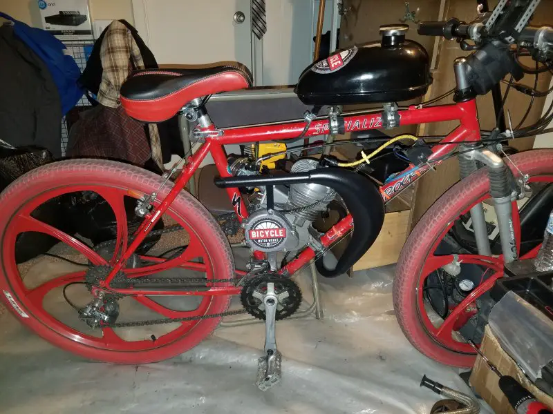

Wow! I almost have that exact set up, except I have a Mikuni VM18 carb and the MZ65 pipe. If I wind it up, I can hit 46 mph on a good day, but I seriously don't like going that fast, the bike is so light, not like a motorcycle, I feel like a big gust of wind from the side and I won't be able to hold it.
  • Like
Reactions: Greg58
indian22
Dec 31, 2014
4,067
5,485
Oklahoma
Tyler you've got a nice setup & it's running well, but your motor is a case inducted reed & that makes it a really different motor from the cylinder reed port design Warphones is working on. Neither one of you has yet reached the power that these two designs can produce when tuned to the max. There are guys that build "port timed" motors that fly by fifty mph. It's all in getting your tune on with the components you choose to run and the basic motor design. Here's the order of design that I find it easier to make power with using a 66cc China girl #1 case inducted reed, #2 Cylinder reed port with window piston and #3 port cylinder. port timed engine. Note I said easier & not easy because getting any of the three to really make impressive power takes work and money, maybe your own work but there's the option to pay a pro to build it, and that gets pricy. Going fast is dangerous on a typical bike frame
I like both you guys motors to this point and see no real reason to do a lot more as they seem to run well right up to the point they're at, but either one can make more power.
Tyler p.m. me about that feeling you get at high speed 'cause I run the same style frame and know they can get real flaky going fast.
I'm jealous on the mz65 and carb. Good looking bike! Sweet fmf silencer! I love tinkering on these and pushing the limits!

Thank you both for your kind complements on my bike. It means so much coming from guys who are such excellent bike builders and who know what they are talking about! I've seen the case reed design, I'm certain the more direct fuel dynamics would make a pretty big difference over the type I have. But I'm happy with the power of my bike, I'm not particularly that interested in hitting 50 mph on this thing, I'm no longer a young man, it is what it is.
  • Like
Reactions: FOG and indian22
Tyler6357
Mar 15, 2012
1,169
187
Santa Barbara, CA
Yeah, that's a FMF Powercore 2 silencer. I would have never put it on the bike but I got such an unbelievable deal on it that I couldn't resist. They have a shorter one they call "the shorty" that might have been better but there was no deal on that one. One thing is for sure, it's very quiet with that thing on there.
