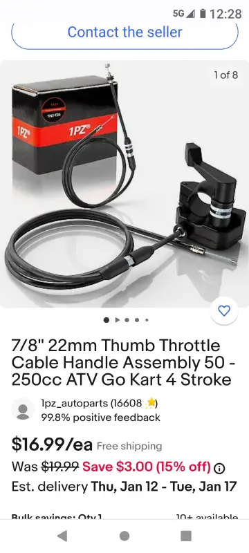

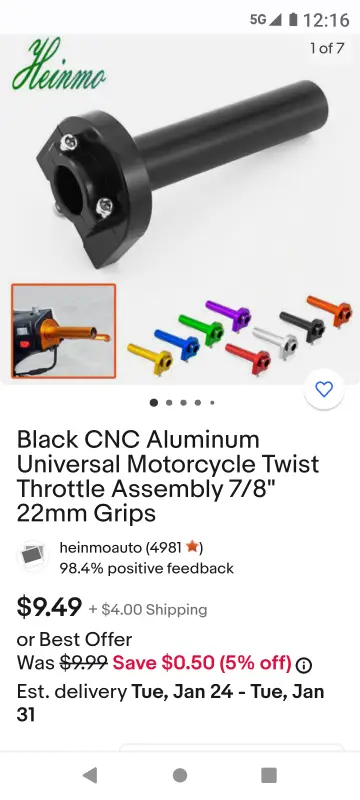

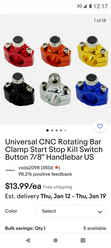

This is the upgrade throttle and kill switch... There's a few colors choose from and put some light grease in side the handle part and some light oil in the cables then it will out last everything else and there a thumb throttle some people like so they can hold the bars better
