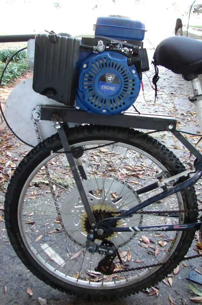

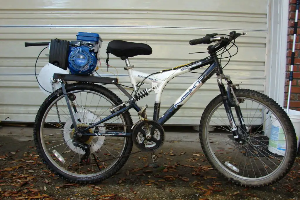

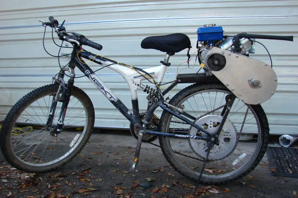

Well I finally finished my bike about two weeks ago. Took some pictures today. Here they are.
Uber cool! I had thought the size of the HF would seem to big. Looks great!
How is the sound, weight distribution and over all JOMBing? (Joy Of Motor Biking) on her? Full report!

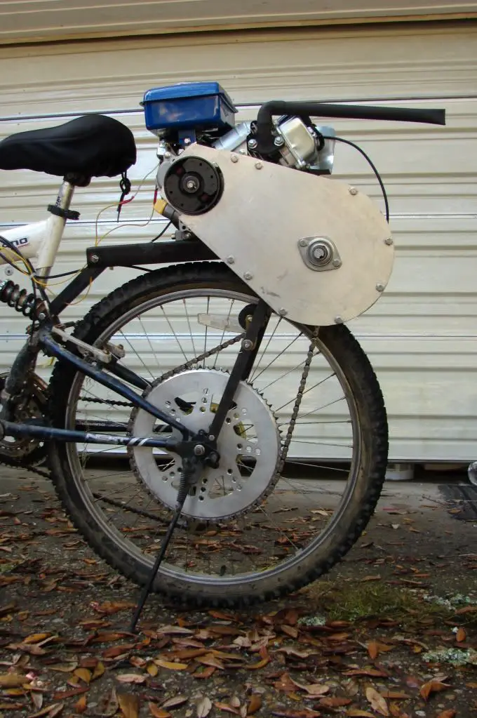

Oh! tranny looks beautiful. Working well?
.flg.
Great job. What is your final ratio and how did you fasten the sprocket to the rear wheel?
That thang looks like it would pull a stump.
Hi. What brand of clutch is that? Max-Torque? It doesn't look like a Hilliard. Also, how thick are the aluminum sidewalls on your tranny? Last, where did you get your rear wheel sprocket?

It sounds great but I may end up putting a muffler on it. I am having a little trouble starting when cold. If I put a baggie over the exhaust it fires right up. I had a longer exhaust (sounded better) to begin with but it got in the way a couple times and broke off so I cut it down to the size in the picture.
The balance is better than I expected. It is a little back heavy but that is to be expected and not really all that bad.

The total ratio is about 19.7/1. The tranny is 3.1/1 and the final reduction is 72t/11t or 6.5455/1. I think 11t is correct.
atombikes: the Sprocket is one of Creative Enginerings pieces of art. It may take a while to get your item but it is worth the wait.
The clutch I am really kinda proud of I did my homework on this one its a Comet SCP 350 series. I got it off of Ebay for $25 then I bought another about a month ago for $18 for spare parts.
You did a great job on your tranny. Any idea how much money it took to make that? I agree with Dan that the engine sitting there on your bike doesn't look as big as you'd think it would and it's nice having the gas tank right there on the engine. I imagine it has plenty of power.

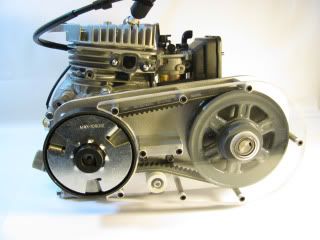

That would be the biggest complement if you made one like mine. If you want/need I can give you all sorts of info as far as pricing and materials. I have to admit I copied someone elses design he has a see though cover plate though.

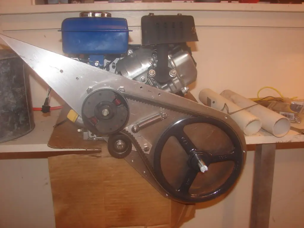

Mine has a spring loaded tensioner. The one dan posted had a tensioner put on it after that picture was taken.
Here is the inside of mine
here is the other one
