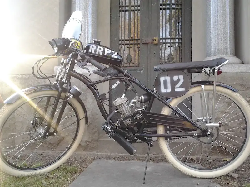

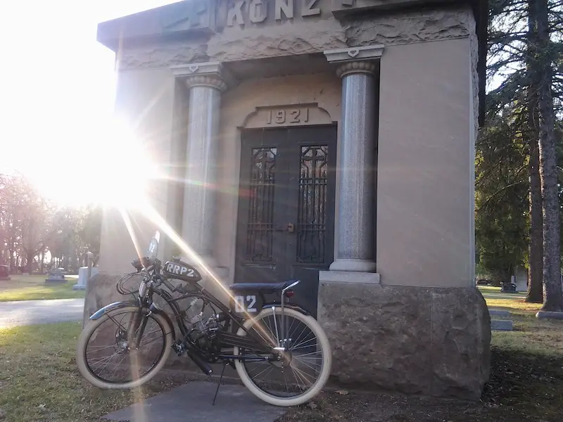

I suppose it's fitting that the last photos I took of R.R.P. #2 was in a cemetary.
Because it's dead.
Long story short, the chain got thrown at speed. Which was (last I looked) mid 40's. The chain went everywhere, the wheel locked, spokes broke, my hands got thrown off the bars, almost rear ended a car......
.duh.
Now the frame has tweakage, and a slew of other issues.
So.... R.R.P. #3 is now being built.
R.I.P. Ratt Rocket Psychle number two.
